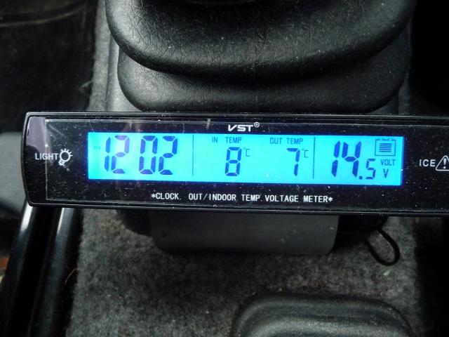

The one thing I missed a lot on my jimny was not having an external temp display. So I tracked one down on eBay and it works well
Ran the sensor through the wiring boot at the door hinge and up to the nearside mirror. To ease fitting I took the mirror off and fed the sensor beyond the rubber seal and down to the mirror hinge. There is an existing drain hole that I enlarged a fraction to allow the sensor to fit, but I did drill a new drain hole alongside.
Sensor location (wee silver dot)
Sensor location looking into the mirror.

Very tidy installation & thanks for the pics ............

Hi, Do you have the ebay link? I have been hunting around ebay and cant find it. Fancy one myself.

This looks really good ninecherries like it came like that from the factory.
