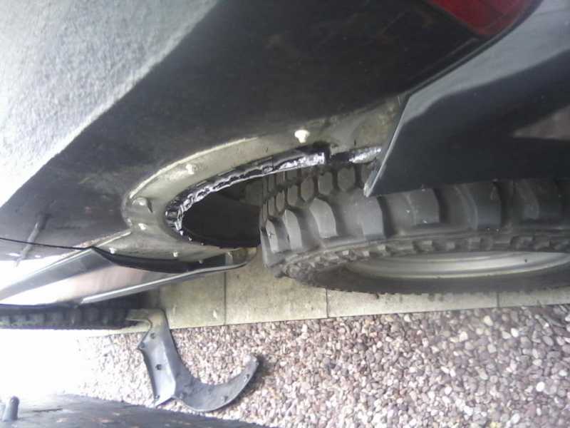

A bit of trimming and painting.

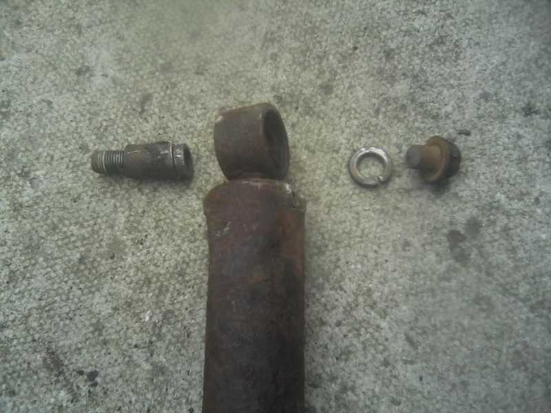

This is the bush that was stuck to the bolt so as i unscrewed it it opened the bracket up. Quite hard to get at with a grinder, the drivers side one i chopped the shock up to get at the bolt but on the passenger side i got some heat on the bush and pushed the shock and rubber bush off the steel bush leaving room to get a cutting disk in.now all replaced with bolts from the big jimny shop.

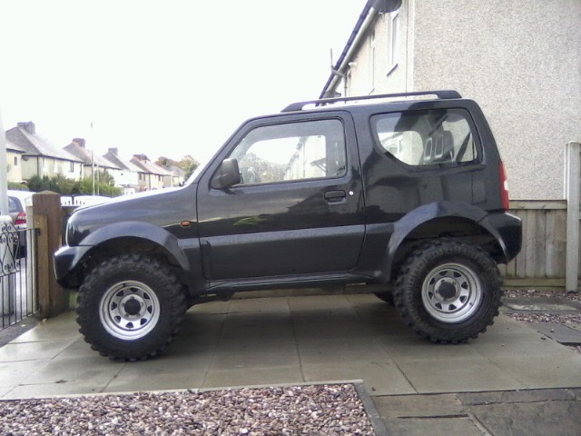

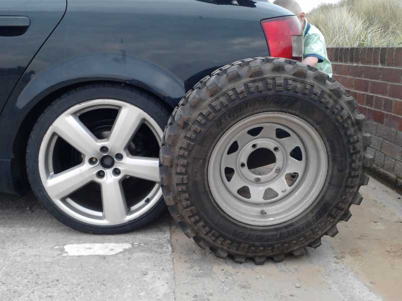

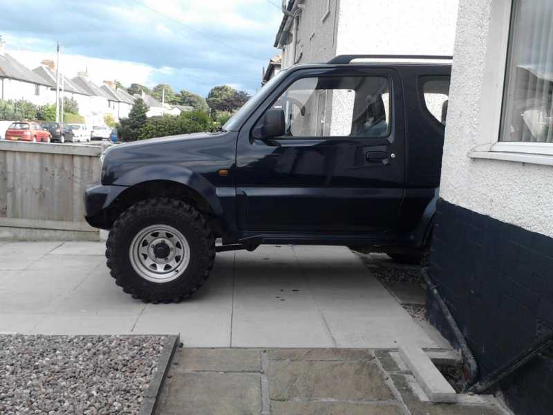

a pic of my jimny wheels against my 19inch audi alloys the tyres have balancing beads for perfect balancing at all speeds.
a pic showing all the car for a change.
