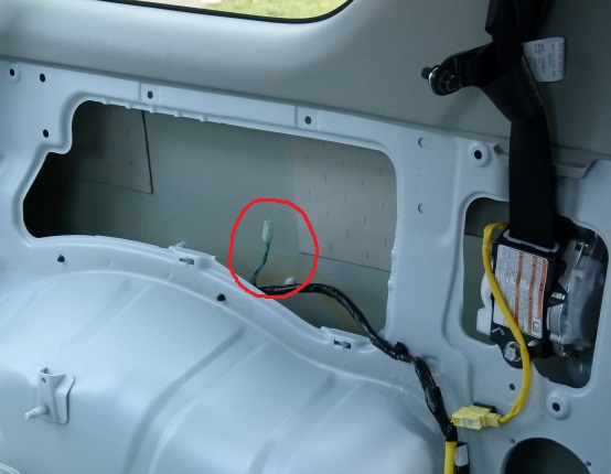

no you will need to buy additional speaker wire, should only take a few hours not a weekend lol :whistle:
Replied by jonesyba420 on topic Halfords Dog-Taxi
hunter1084 wrote:
Halford wrote: Rear speaker wires only on nearside (that's the side without the fuel filler for peeps who drive on the wrong side :whistle: ).
You'll need to run the cable to the rear right yourself
Cheers for that
So the cable that is there will be long enough and I wont have to buy any additional speaker wire?
Sounds like itll be a weekend job!
- Blitz
14 Jan 2015 19:49 #135105
by Blitz
Replied by Blitz on topic Halfords Dog-Taxi
Many thanks Halford for your info and pics. Fitted front speakers in 20 mins no problem. Fitted ear speakers in about 5 hours. Didn't realise I had to remove half the bloody Car to get access
still got a few bits left over.
Admit without your post I would of never guessed that plug on a main wiring harness was for the speakers. In fact mine was taped up onto the harness which gave me a little Hart attack until I noticed.

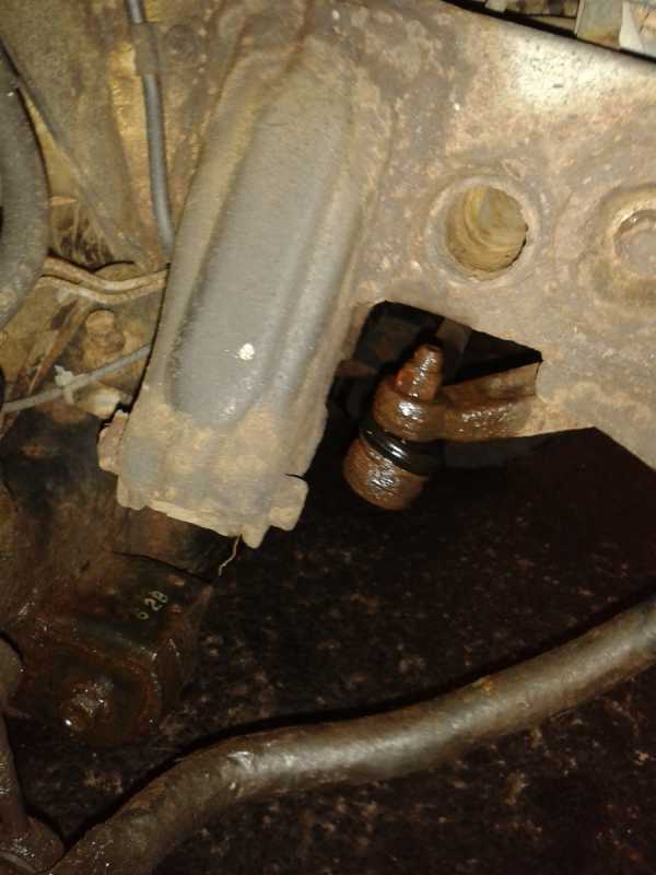

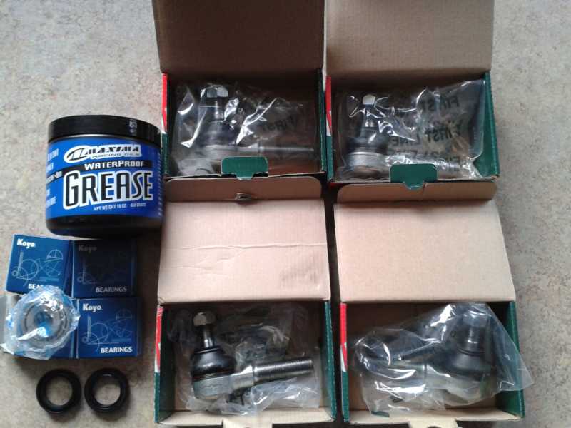

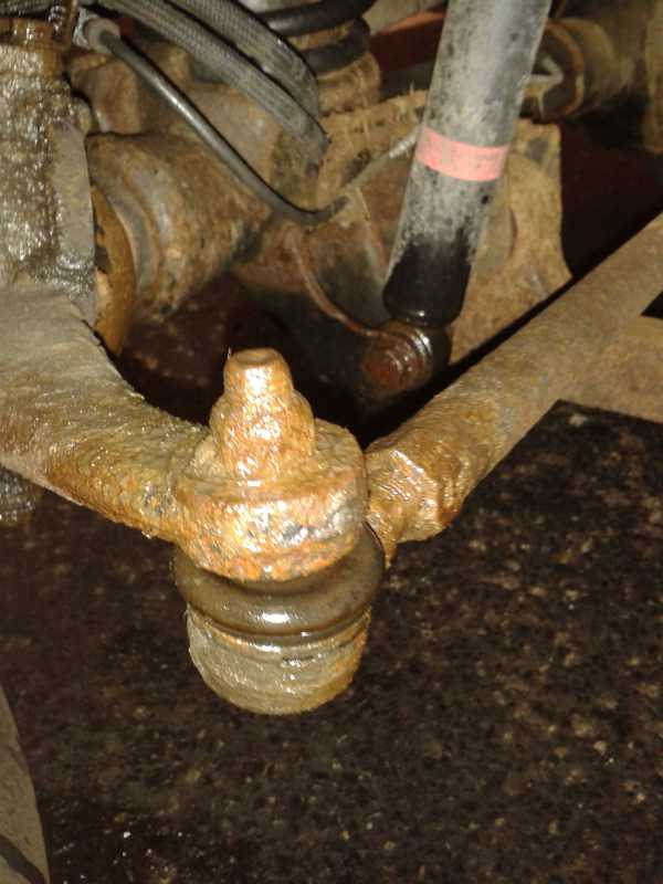

well I had my kingpin bearings and front drag rod track-rod ends changed today
with the assistance of Gaz Gaz3359 and his reasonably priced jimny.
and the good news is that death wobble (which was pretty severe at 43mph) has totally gone :woohoo:
the minor bad news is that I need a new tie-rod (tie rod = rear, drag rod = front) with the the track rod ends removed, Gaz tried brute force (and he's not a small lad) and flames but there was no way the ends were going to budge, but never mind as the track rods ends still look OK-ish
........... I feel a PM from someone called James heading my way soon :whistle:
Overall I can feel a much improved feel and ride at all speeds, hadn't realised how bad things had got, :whistle:
however, can now notice very minor tremors at 30 mph or less, doesn't feel like a wheel balance issue as the feeling isn't direct through the steering wheel ..... wonder if this is the older style control arm rear bush issue that Suzuki have reported on Jimny's up to VIN JSAFJB43V00422454.
