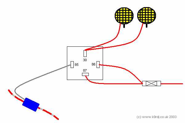

I have fitted my spot lights using this relay wiring diagram:
I got it from this post: www.bigjimny.com/index.php/forum/6-jimny...-wiring?limitstart=0
So thank you Dave!
On the back of the headlamp plug you need to pull the rubber insulation off of the plug its self and look at the back of the plug where the wires are crimped into place. You need the red wire with grey dots on it marked 'drive' on the plug. You'd think it would be the one marked 'pass' but it's not.
I scotch locked onto it. I don't like using them but it was the easiest way to do it.

Diagram from 2003 still going strong?! I still have my uses then?
