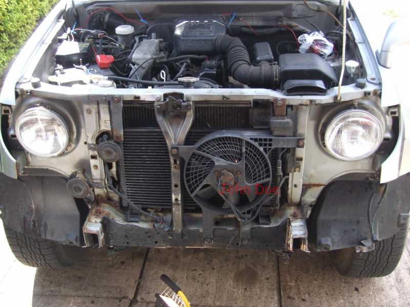

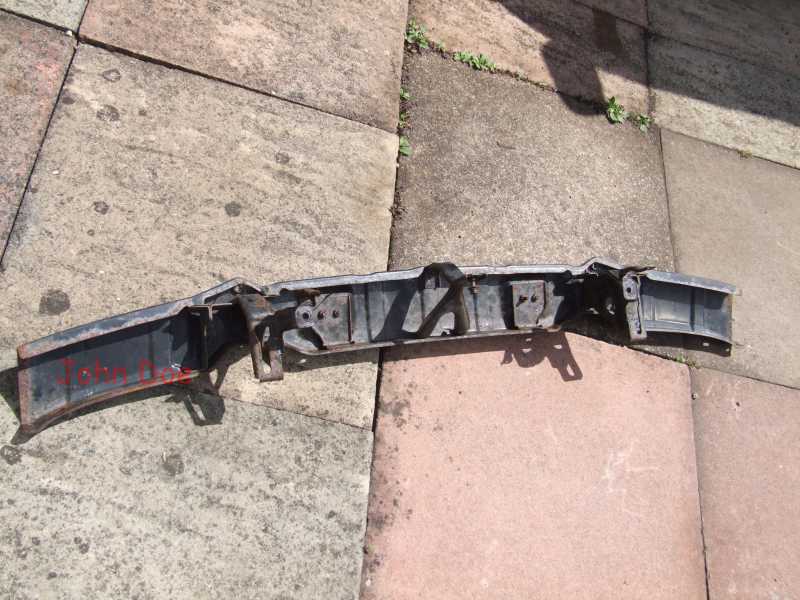

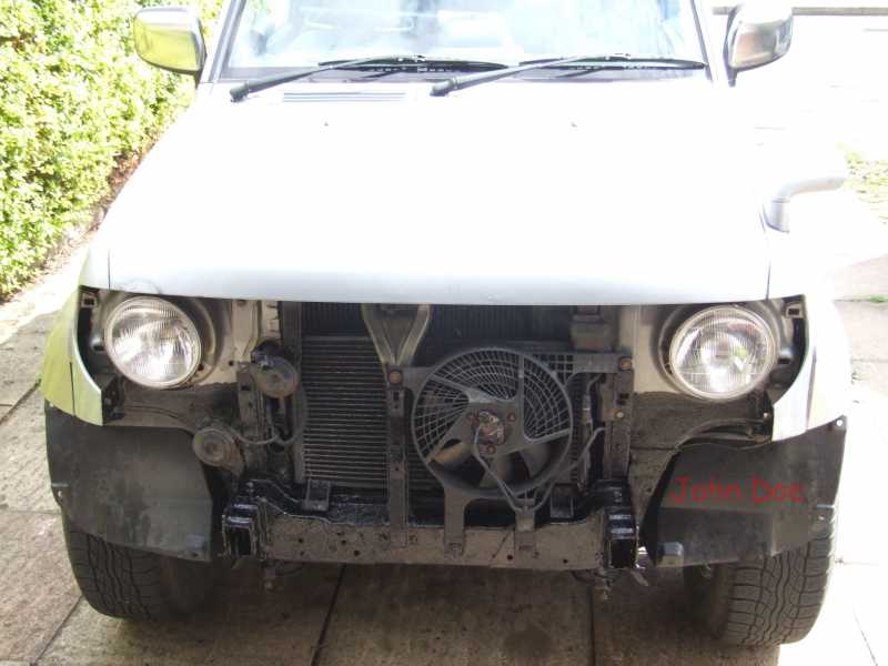

Quite by chance just I am dealing with the last bit of rustproofing. I left it cos I needed to remove the bumper and with no workshop manual it was going to be a nightmare.....and it was! :laugh: Three hours to get it off. :angry:
Now here's a sight not often seen online. A Junior with the bumper removed.
After rotary wire brushing I have treated all rust areas with Jenolite and then applied a liberal coat of Hammerite underseal with added Waxoyl. It will be dry enough to handle tomorrow so I can reassemble and get back on the road.
Also gave the same treatment to the bumper frame.
