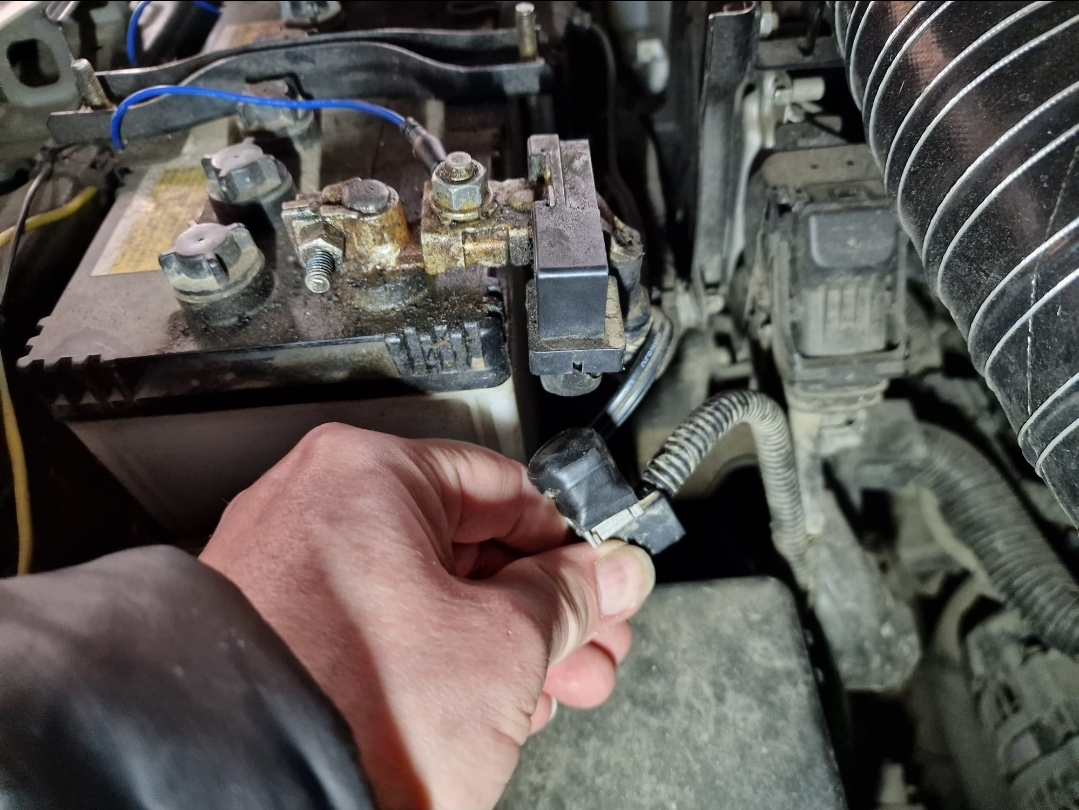

10 Oct 2026 13:09 - 10 Oct 2026 13:11 #265378
Does you vehicle have a similar set up?
Replied by Soeley on topic Tool suggestion please
I unplugged the connector on the battery negative shunt on my Jimny back in April 2025. It now has a dumb alternator and constantly charges at 14.4 volts. Before I did this I was constantly getting messages from my tracker that the vehicle battery was low, now I don't get them.One of the more recent ai suggestions is to trick it into charging at 14.4 by running with the headlights actually on instead of auto as allegedly that tells the ecu to get the alternator to just be an alternator.

10 Oct 2026 15:23 #265381
Replied by Lambert on topic Tool suggestion please
I don't know but I'm about to go find out. Thank you.
