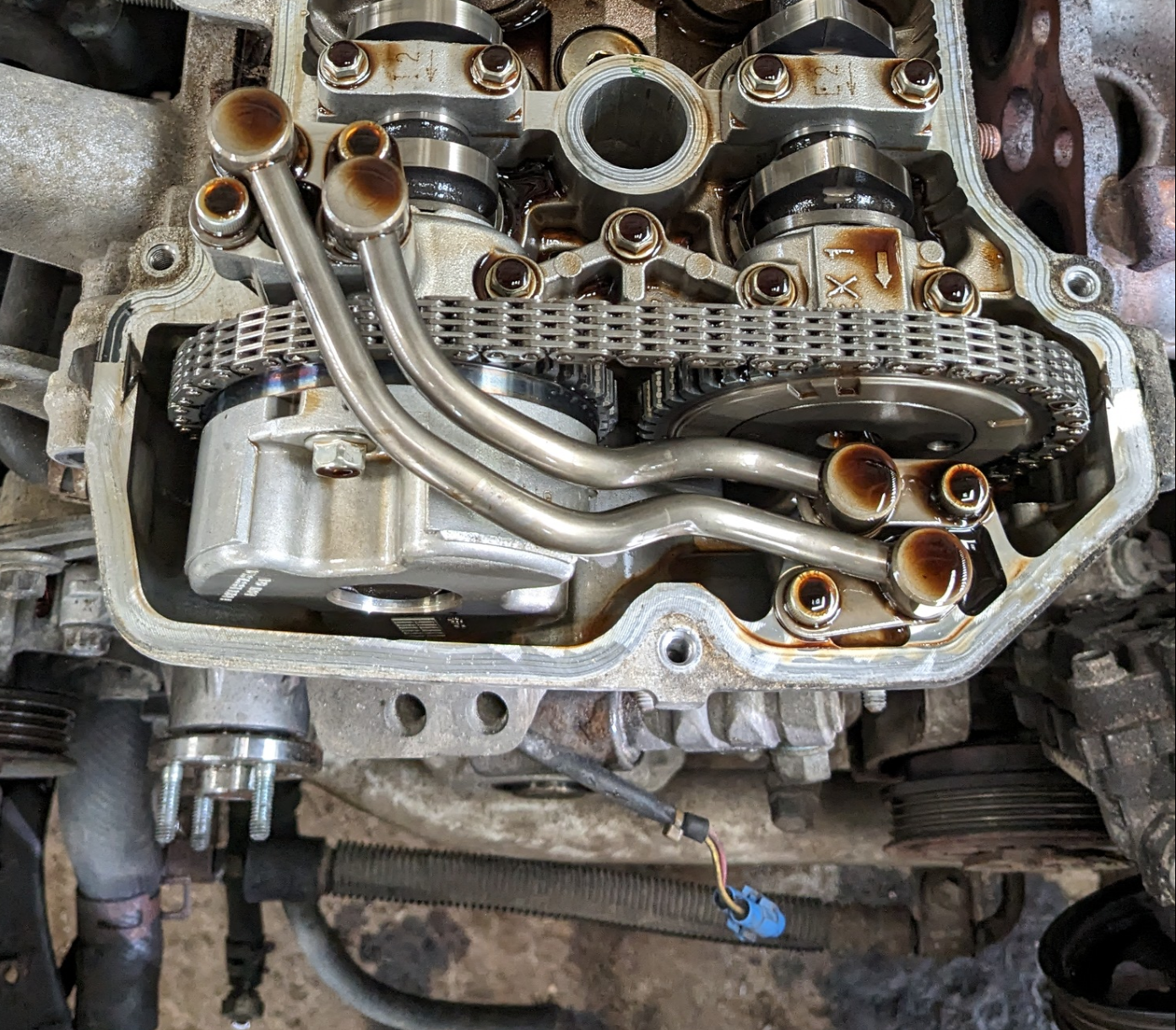

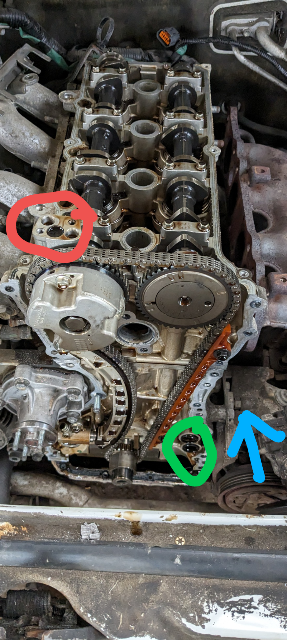

Good question! I don't know for sure but let's do some detective work...
The red circle shows where engine oil is fed to the actuator on the end of the intake camshaft. This is the VVT bit. The green circle shows where this oil feed originates from the engine block. Between the green and red circles it goes through the timing cover (not present in the photo). So the solenoid is either on the front of the engine in the timing cover (blue electrical connector I believe) or somewhere on the left hand side of the engine where the blue arrow is pointing. Unfortunately I don't have a VVT engined Jimny nearby at present to check.

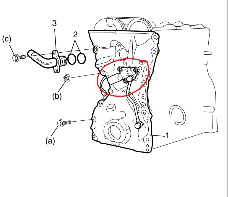

It is supposed to be bolted onto the outside of the timing cover half way down. (I've never seen one though
