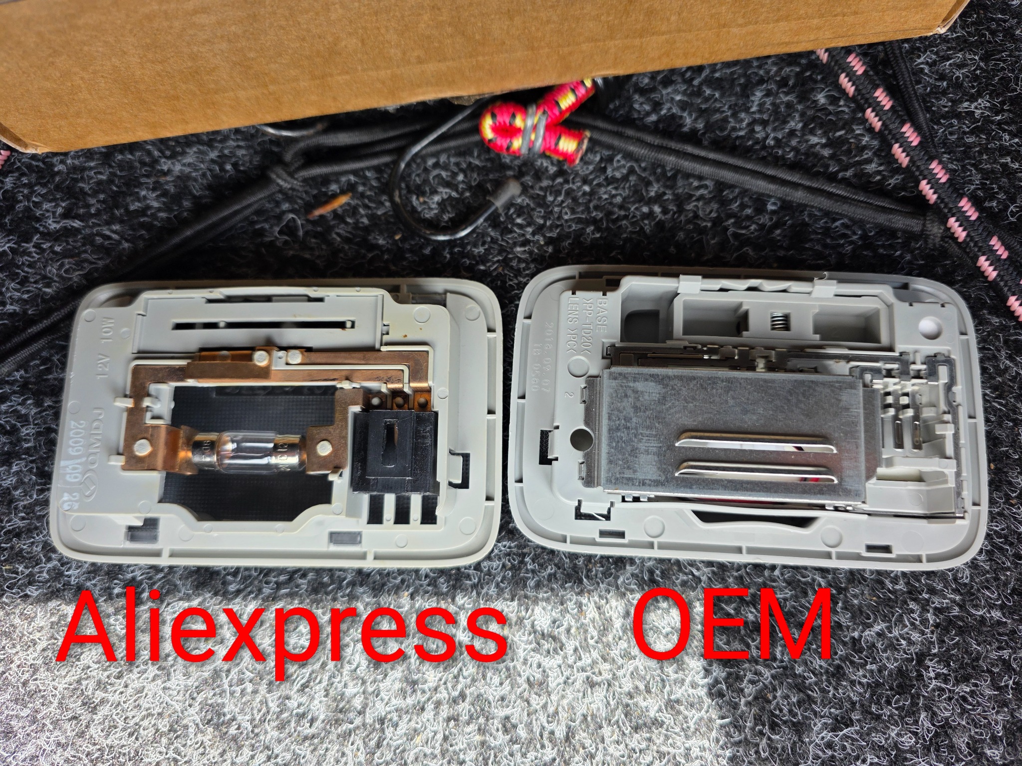

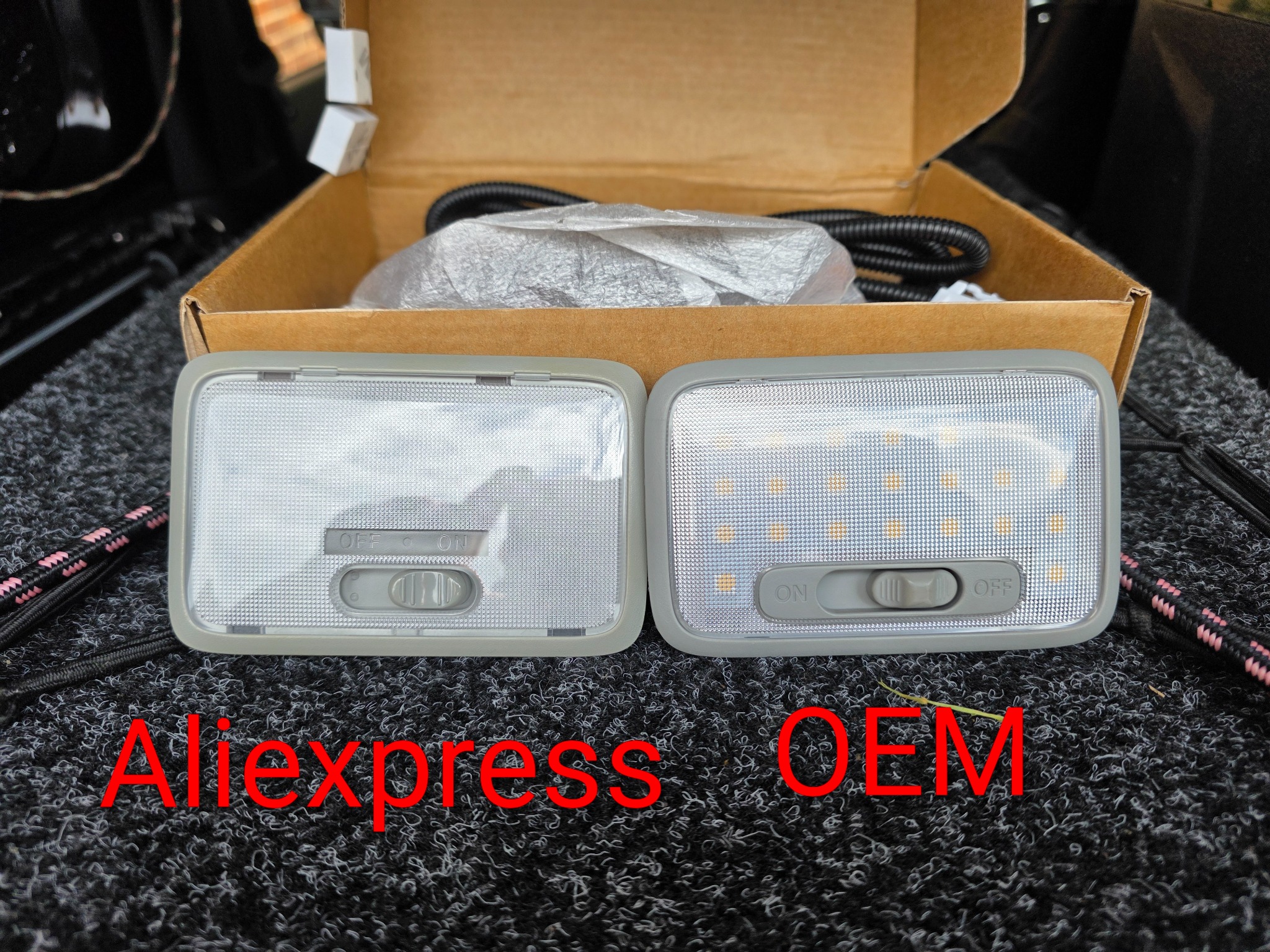

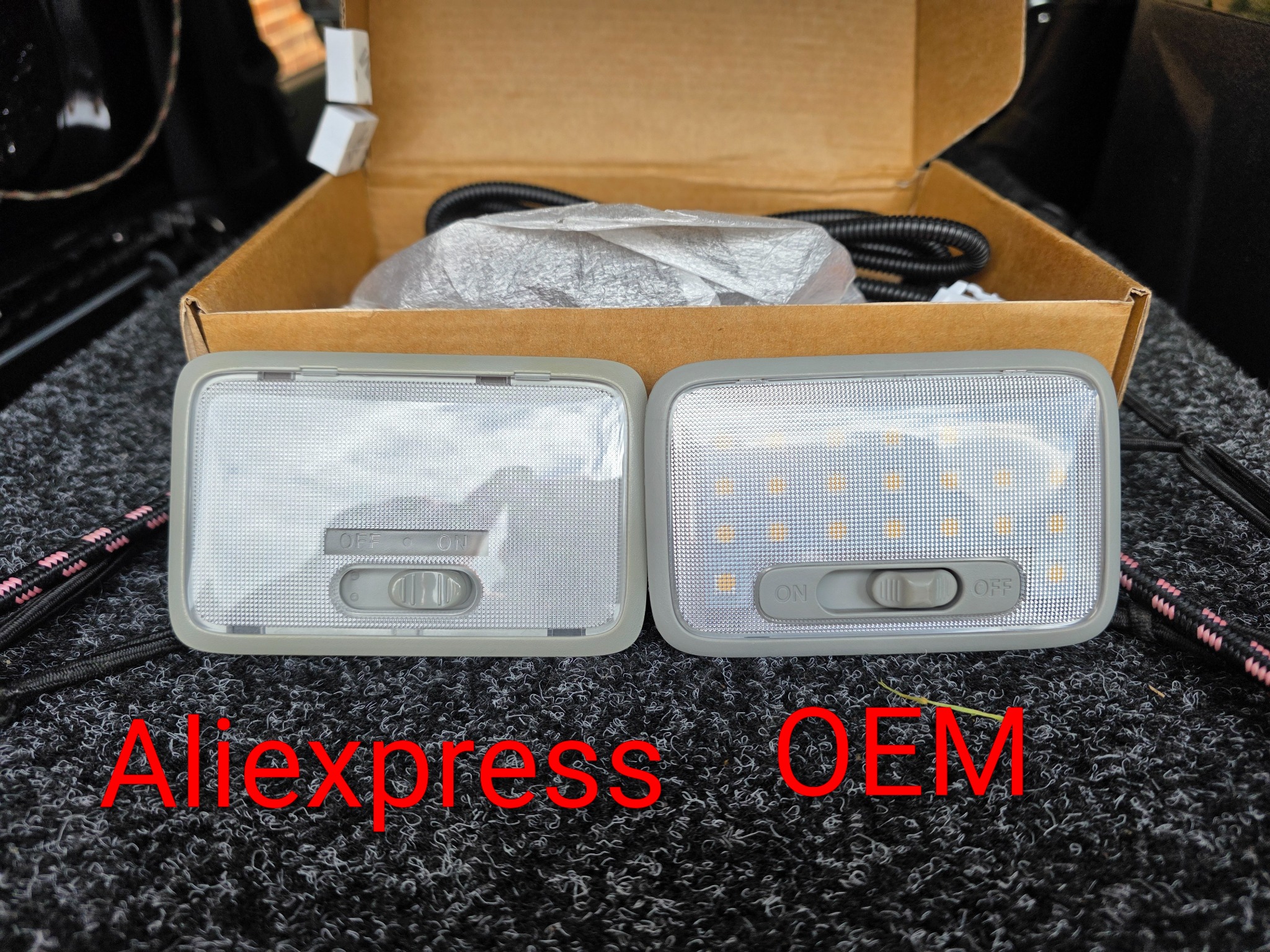

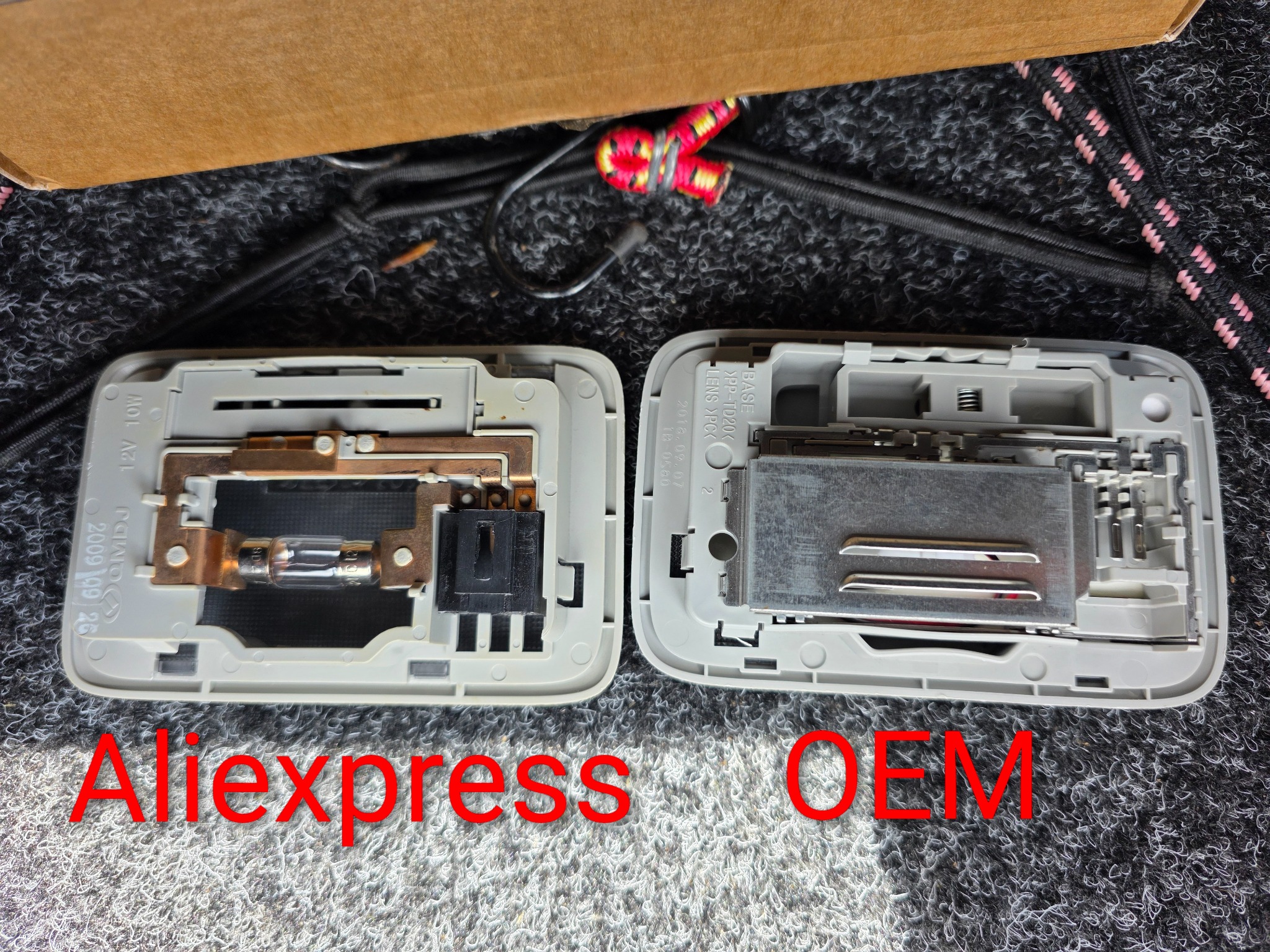

You can get these from AliExpress, I got one for a project I'm working on. My SZ5 has the OEM light in the rear as standard.
As you can see the AliExpress one is very similar to the OEM one
The rear, it does seem it will fit in the hole in my roof lining and metal bracket behind. Does yours have the bracket in place, so you just need to cut the headlining?

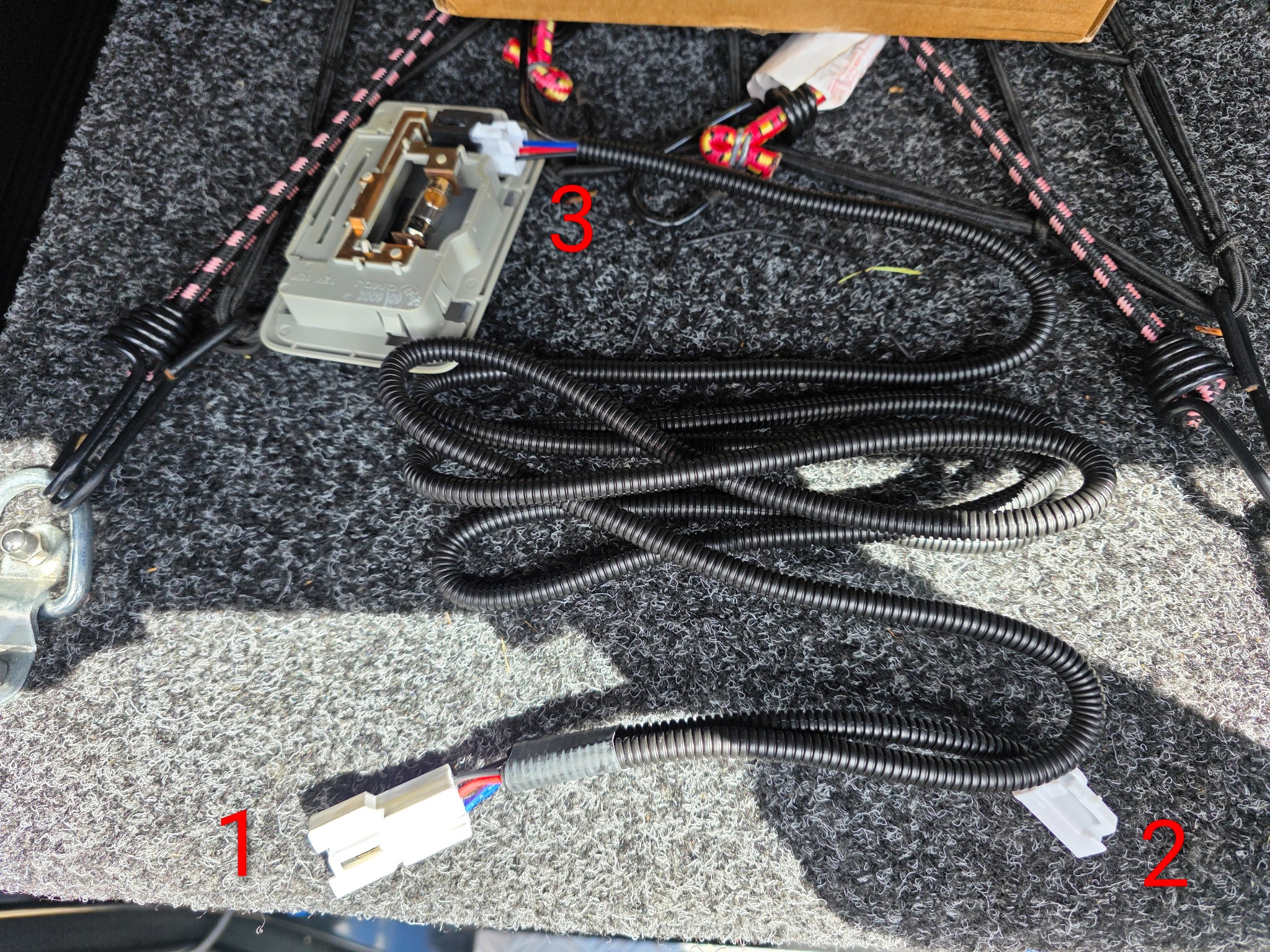

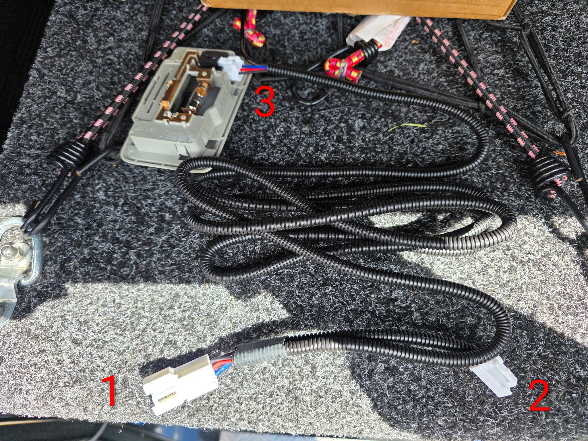

Connections:
1 - Connects to the plug that goes to the front interior light.
2 - Connects to the front interior light.
3 - Connects to the new rear light.
