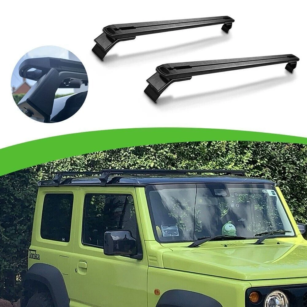

For what year Jimny are you looking for? On the 2018 and onwards, the roof bars are mounted on the gutters. I found a very good one on eBay.
eBay Link
eBay Link

I've searched extensively, but not found a similar image. Do you have a link?

It is a generation 3 2013 model. The problem these days is the internet is flooded with everything generation 4, making it harder to filter for earlier models.

Shamelessly stolen off a Google search of an ebay listing.
ebay item number 126571303778
Second image in listing when zoomed in shows the clamp on bars to carry the rack. Note the listing is actually for suspension.
