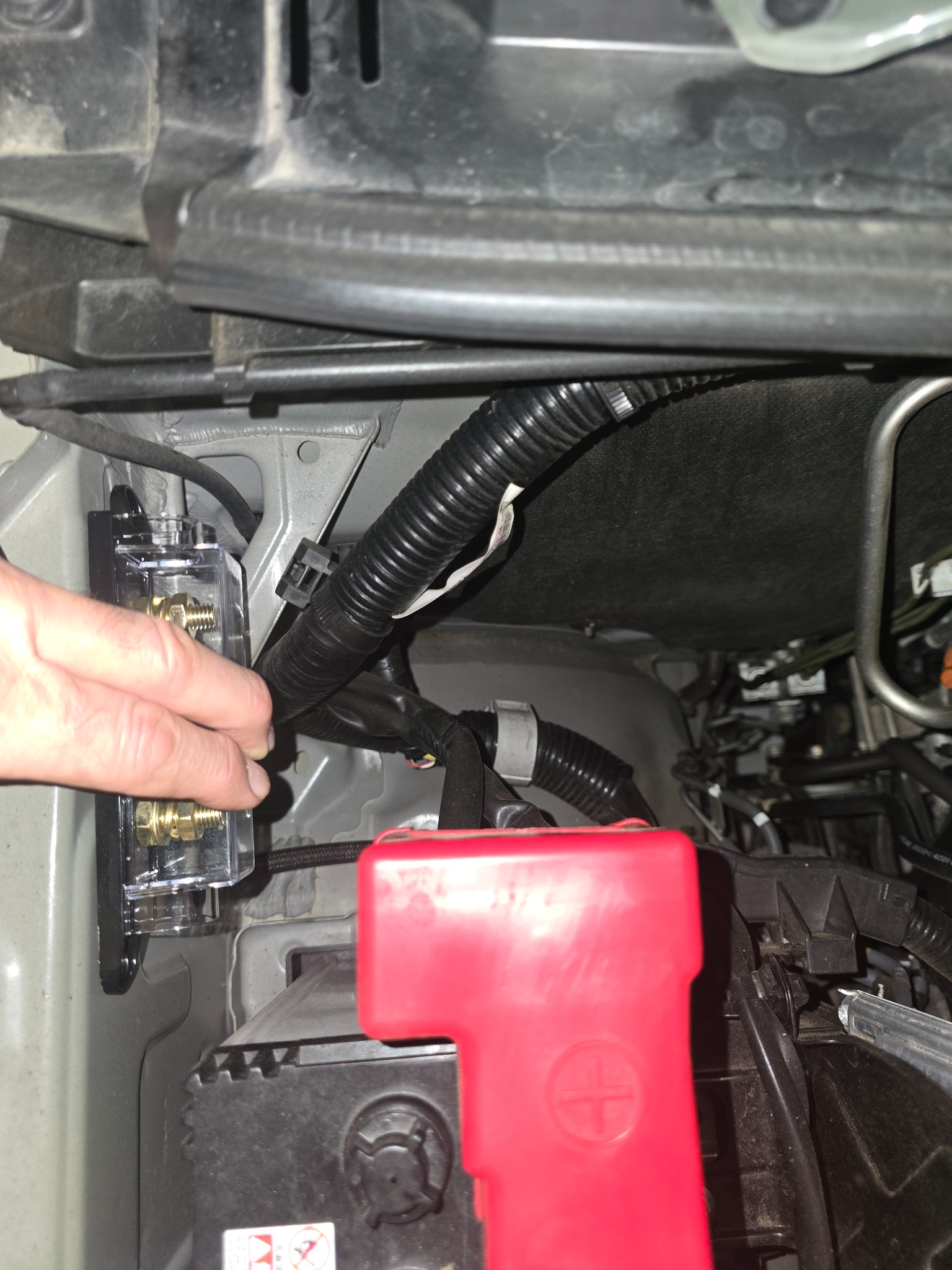

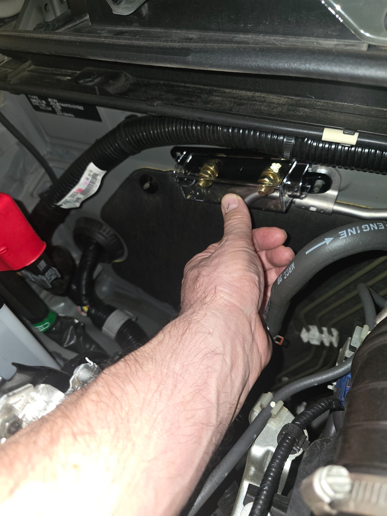

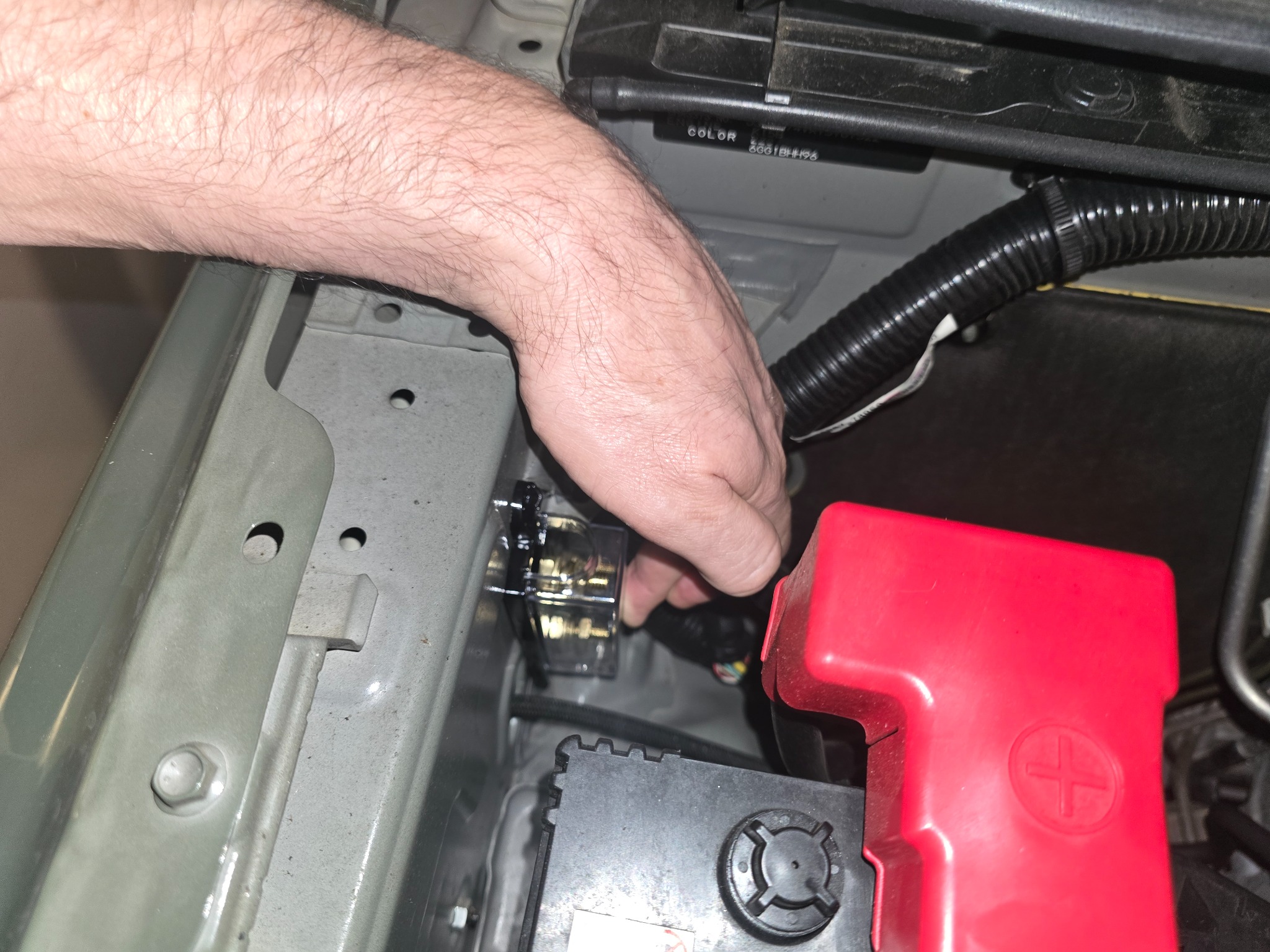

I need to install a single fuse, aftermarket fuse box within 12 inches of the battery to power a subwoofer.
Anyone have any advice or pics of good locations? Also, there are 3 accessory connections on the positive battery terminal. Can I connect to the rear passenger side one?
Below are the areas I've found so far:
Passenger side between battery and firewall. Directly above firewall wiring grommet grommet. Horizontal.
Passenger side between battery and firewall. Directly above firewall wiring grommet. Vertical.
Firewall near battery. Attached to existing bracket and a sheet metal screw thru firewall. Above and to the right of the passenger side firewall, wiring grommet. Horizontal.

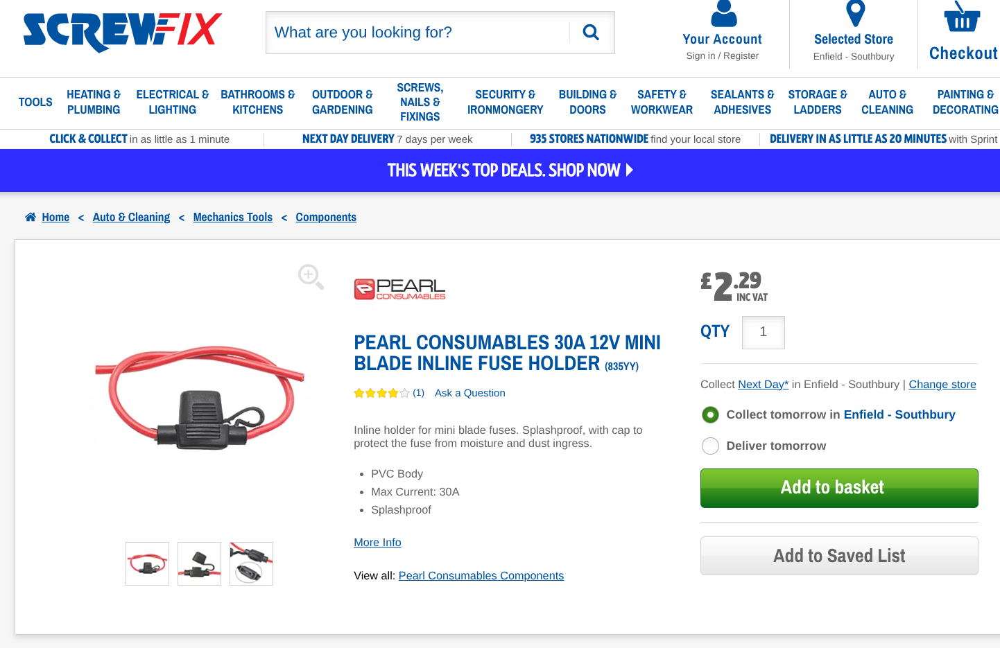

Haven't seen those in a while. I'm running an 8 gauge into the cab for all my stereo stuff on a 10 amp inline fuse, slightly bigger than the one Busta shows as it's manufactured into the cable. I think it was part of a prewired kit. Either way it's quite happily running my 4x100 head unit and 200mm under seat powered sub. If I were using your one I'd probably glue it on the inner wing as close to the battery as I could.
