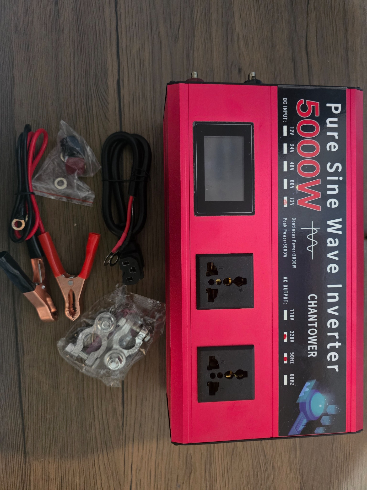

As that unit is rated at 2000W continuous output (really??) it will need around 200A, so the cables will have to be rated to take it with minimum voltage drop, the battery cable in the picture seems comically thin. Tbh, I'd expect the engine to stop after a couple of minutes if you are pulling 200A from the 12V system unless you have a huge battery.

It worries me to look at the croc clips and wire it was supplied with, try to draw 200A through that and the temperature rise rise in seconds until it vaporises. You need to use the battery clamps and cable of around 50 - 100mm2 depending on cable length.
