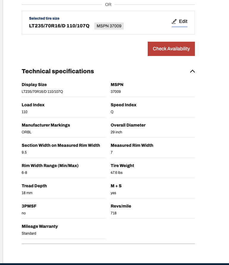

id like to save money and stay with my 16” steel wheels but they are all E rated tires and thus heavier. The skinnier tires are also E rated. Is it better to have a skinny E rated or light wider? I have found one tire that would be nice, the kenda klever r/t LT235/70R16

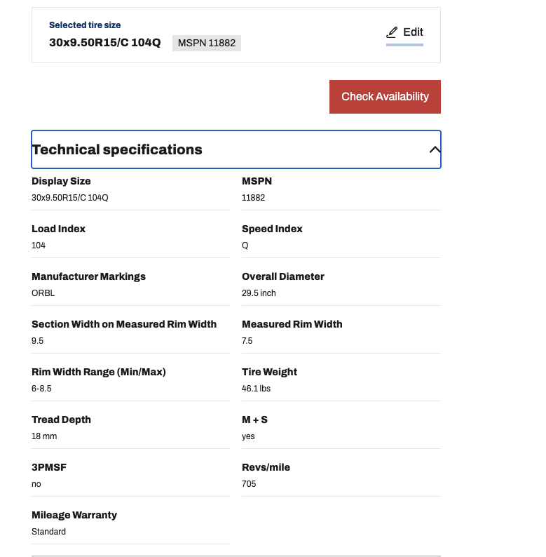

13 Nov 2025 16:09 #262712
by 300bhpton
Replied by 300bhpton on topic Axle Trussing and CV's for 30"
13 Nov 2025 18:10 #262717
by iac27
2006 JB43 from Japan // 215/70R16 Toyo AT3's with 2" RPG lift // Castor corrected front arms front and bushings back // high clearance plastic bumpers // adjustable panhard bars
Replied by iac27 on topic Axle Trussing and CV's for 30"
Thanks for checking. They're about the same 46 and 47. I'm down for a thinner tire but do you have any insight if a load ratting of 110 would still feel ok on road? As well as pushing a 46lb tire?
