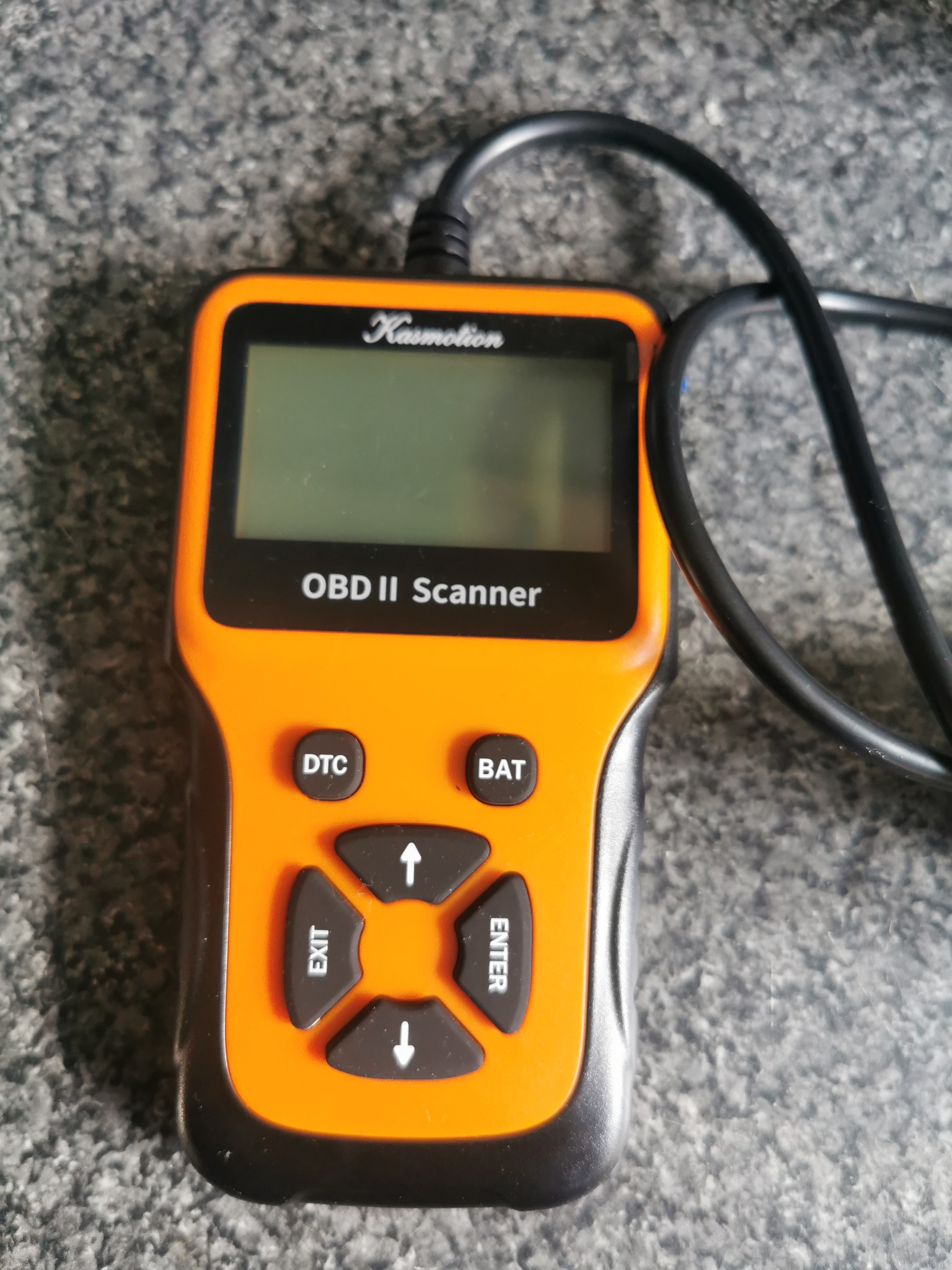

NY cheap reader gives real time readings
I would say check voltage on battery after an overnight rest

02 Nov 2025 23:18 #262574
by Aussie_Shaun
Replied by Aussie_Shaun on topic Gen 3 overheating issue, or is it?
I have also tried code readers, but unfortunately my AUS delivered 2003 is not OBD2. Tried about 6 different readers from about $10-1200 and none of them could read the Jimny unfortunately.
I was hoping to get a read from that sensor before and after replacement for my own curiosity.
