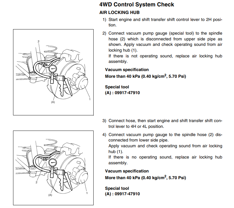

As you surmise, the light is controlled by the vacuum sensing switch, if a vacuum builds up in the pipe then the switch closes and the light can come on steady, so if the pipes are blocked a vacuum can build up but the hubs not work, or if the switch is bypassed to appear to be closed the light still works.
Jump in the car, start it up, wind the window down, and turn off the radio & heater fans.
Select 4WD. You should hear a Click-click from the hubs as they engage and the 4WD light will come on steady (there will likely be a noise from the motor on the transfer box too)
Wait a few seconds and select 2WD, you should hear a Clack-clack from the hubs as they disengage.
If you hear both hubs engaging and disengaging then probably one or both has the pipes crossed over .
Select 4WD engine running, and take off the hubs carefully, you can see if they are engaged or free, the splined collar inside slides outwards to lock and pushes in to free (you can easily turn it if it is free)
If you only hear one, then the other probably has a blocked pipe, someone changed the wheelbearing and got grease bocking the vacuum port or the hub seal ring is mangled from chiselling the hub nut off.
Then you can start getting the wheels off and doing the tests that Hughes posted.
With the hubs removed you can blow through the ports to clear any grease with an airline.
There is also the possibility that the hubs work, but the axle won't drive because one of the CV joints has failed, or the pinion gear in the diff has no teeth....
