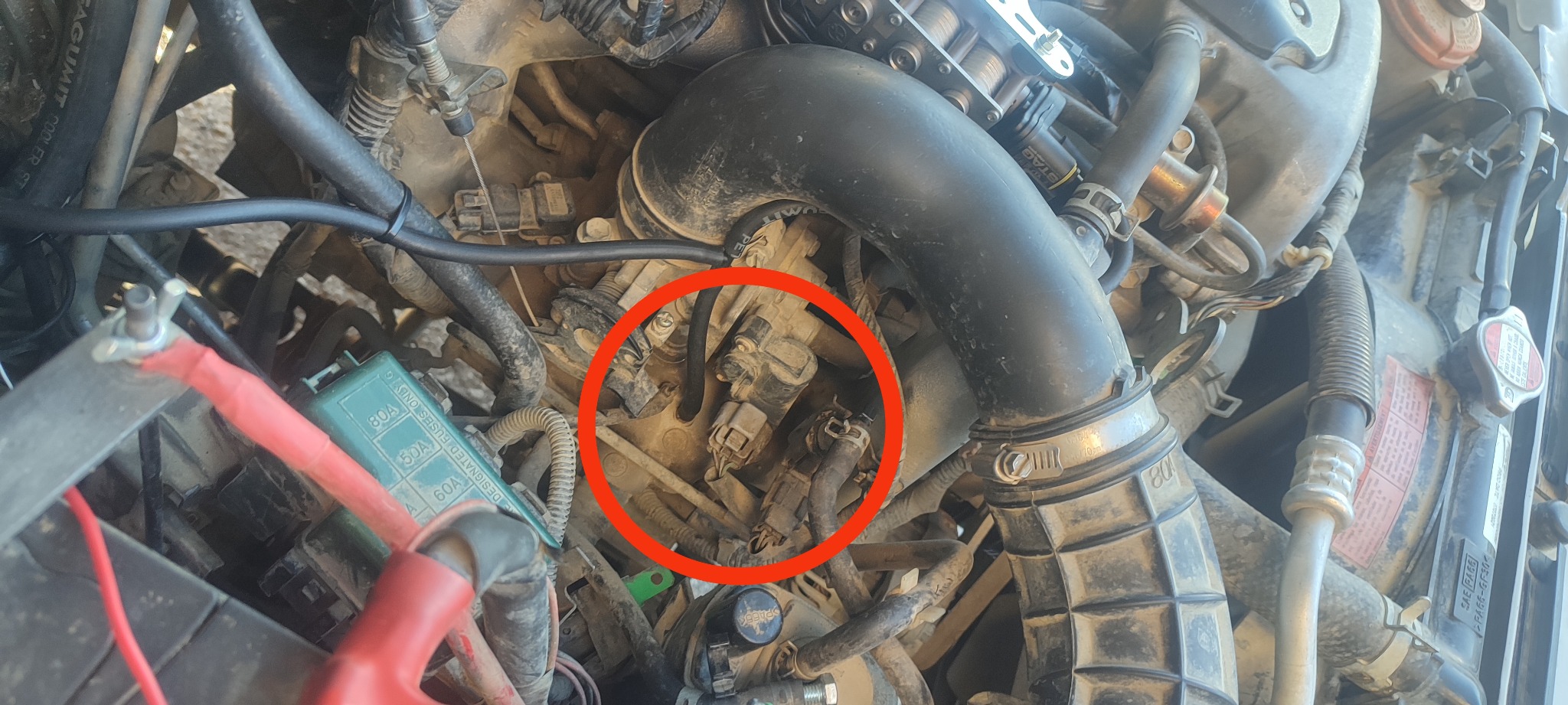

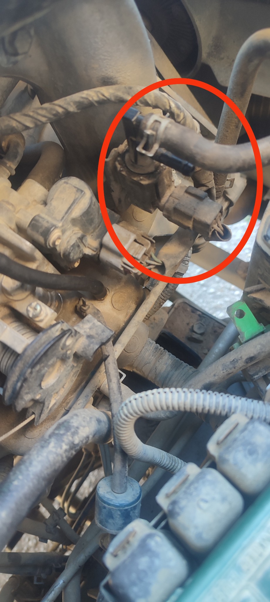

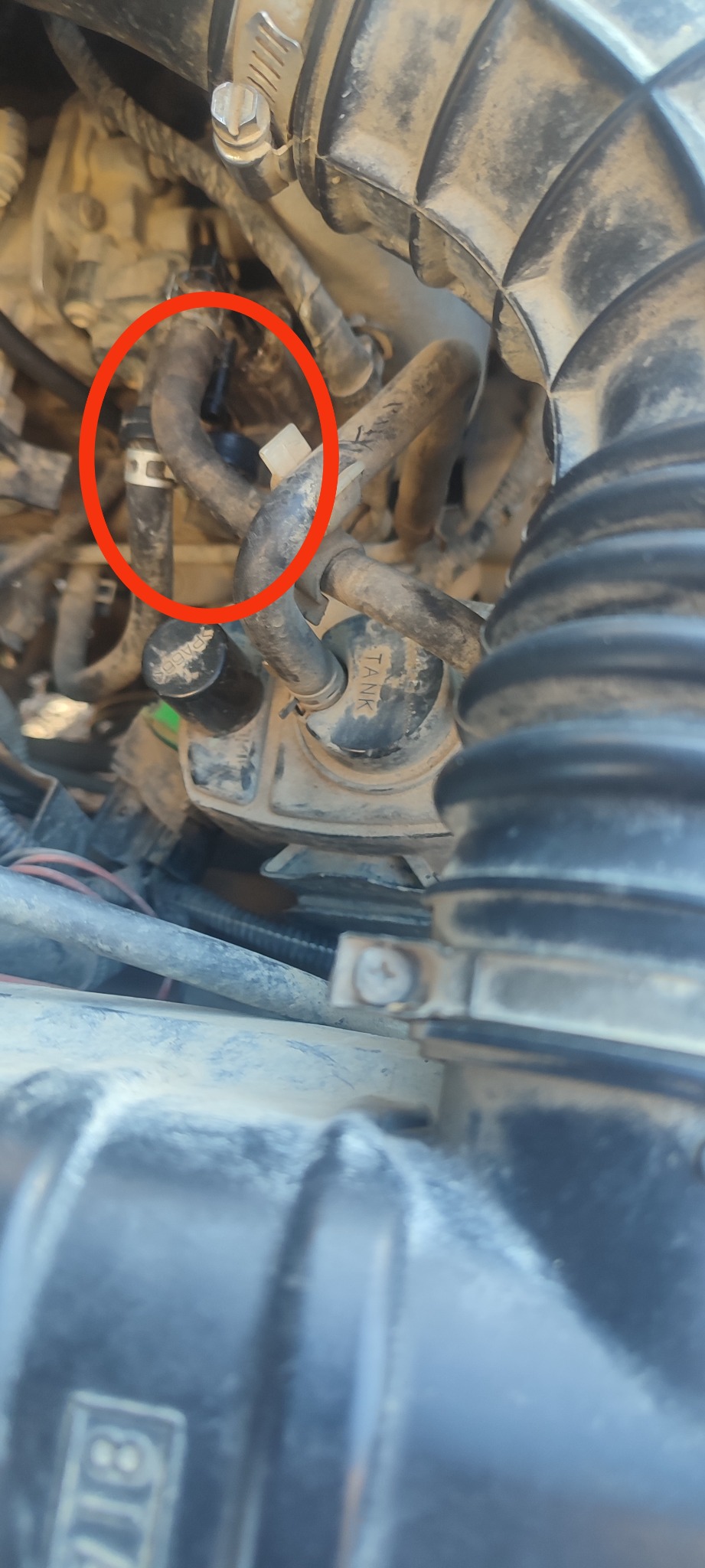

Hello everyone
After a visit at a mechanic shop for adjustments to my lpg system ai found out that ny mechanic removed a tube from a kind of valve and plug it with a bolt. I have some photos of that part. There are 2 rubber tubes. One comes from the engine near the throttle body and goes to that valve and the other tube goes to some kind of tank. This valve ( or sensor) has 2 cables too. Can anyone explain me what is that?
18 Sep 2025 19:48 #262012
Replied by mlines on topic Anyone knows what is this part for?
Evap canister and valves
Captures petrol fumes from the fuel tank and feeds it back into the inlet manifold
