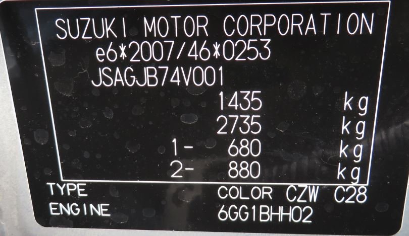

Here's mine from a UK car, the max train weight is 1300kg more than the gross weight, Suzuki and the V5 say 1300kg max braked trailer.
I don't know for sure, but as the vehicle had to pass SVA to register it, it won't have the same type approval as a Euro vehicle.
