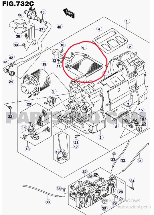

28 Sep 2025 13:32 #262111
by Darthblaker7474
Replied by Darthblaker7474 on topic How to disconnect the radiator hoses in the Jimny 1.5 DDis (diesel)
Do you have a part № for this item?
06 Oct 2025 09:40 #262183
by mauro21
Replied by mauro21 on topic How to disconnect the radiator hoses in the Jimny 1.5 DDis (diesel)
74120-84A00

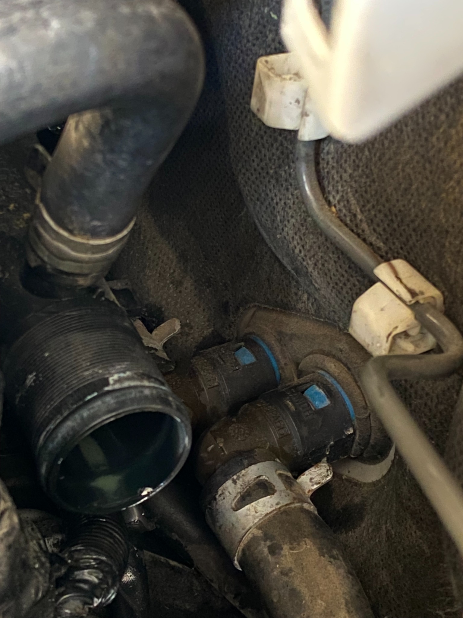

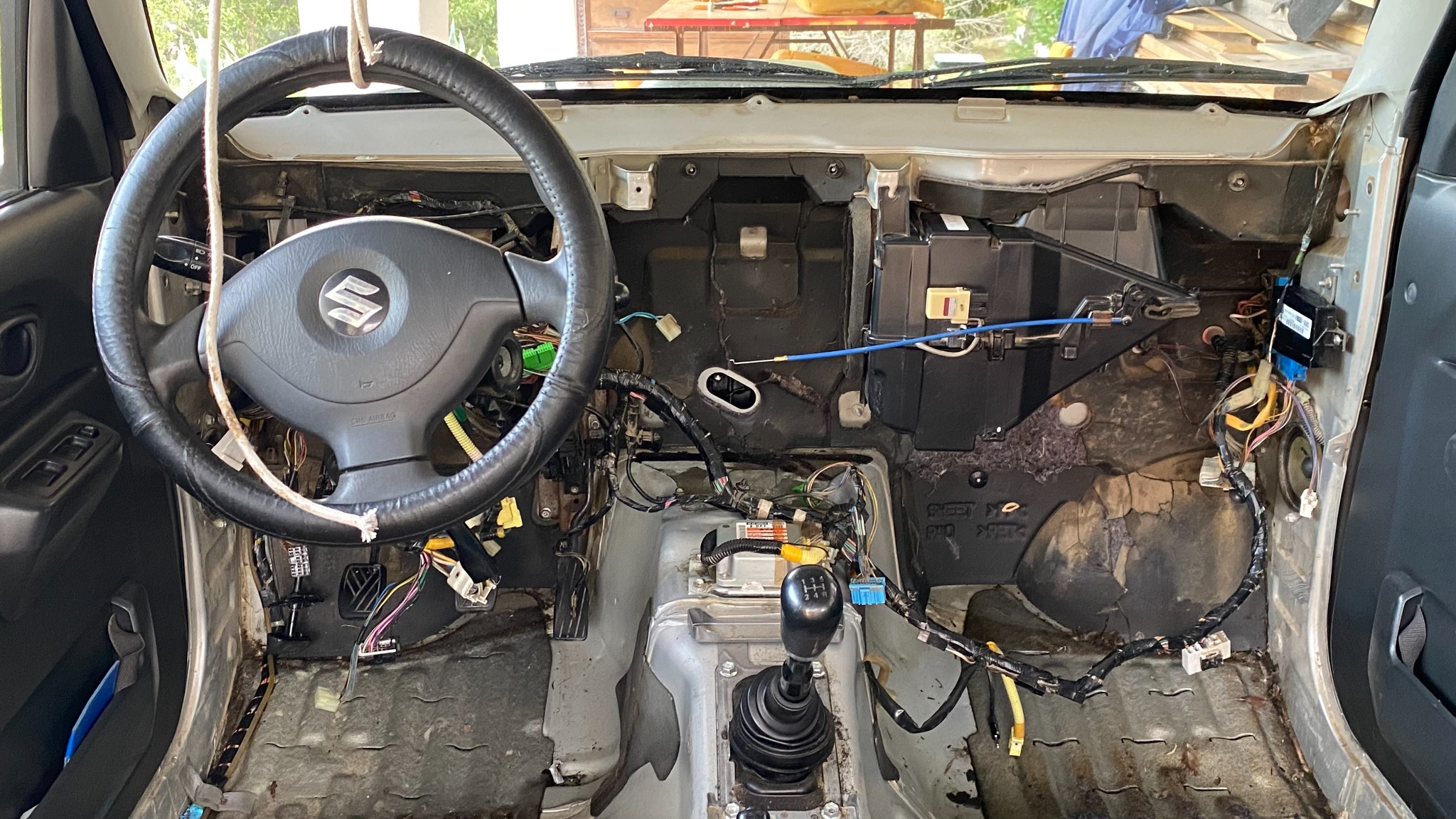

06 Oct 2025 10:03 #262184
by mauro21
Finally purchased a non-original heater radiator for the petrol Jimny in Belgium. I had to cut the supply and return pipes because they didn't match the position of the diesel radiator, so I had to re-weld the two pipes from the original radiator... welding thin aluminum pipes isn't easy! I also couldn't put the original fittings back in, when I removed them, they disintegrated because they were so fragile, they're made of plastic. I could certainly have bought new ones, they cost €8.50 each in France, but unfortunately, when I removed the old radiator, while cutting the plastic fitting, I inadvertently cut a small piece of the aluminum pipe, and a small piece of the ring holding the plastic quick-release coupling came off.
Between last Saturday and Sunday, with great difficulty, I managed to reassemble the heating unit where the radiator is located, using fittings, some plastic and some copper (the bends). I'll test this afternoon or tomorrow to see if there are any leaks
