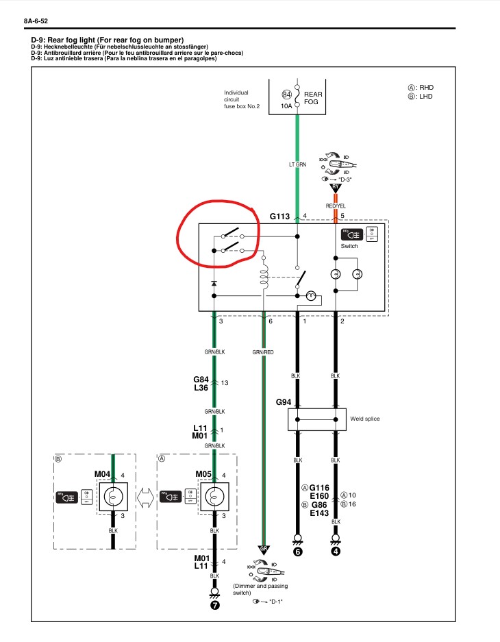

I dug out the very late Gen 3 digram, and that switch sort of makes a bit more sense as they've drawn an extra internal wire.
I reckon that the 2 contacts circled in red are the switch, (I don't know why there are 2) and the other is a built in relay contact. (So you don't need a separate relay)
Best that I can deduce from just the diagram is below
NOTE: THIS IS JUST MY INTERPRETATION OF THE DIAGRAM. (I DON'T HAVE A SWITCH TO TEST) USE AT YOUR OWN RISK. IF THE CAR EXPLODES, BURSTS INTO FLAMES, SUDDENLY TIPS UPSIDE DOWN, GOES BACKWARDS IN FORWARD GEARS OR ANYTHING ELSE ODD HAPPENS I ACCEPT NO RESPONSIBILITY.
So
The light green (4) goes to your fused live
The black (1) & (2) go to earth
Red/yellow (5) goes to the sidelights and illuminates the switch.
Green/Black (3) is the live feed to the foglight
Green/red (6) is the switched earth from the headlights- connect to the red/white from the column if there isn't a green/red.
Probably best to wire up pins 1,2,3,4 &5 and check that the switch illuminates with the sidelights, then try grounding pin 6 and the foglight should switch on & off with the switch, then try connecting pin 6 to the red/white (or green/red)- try lashing this up on your workbench to test it out before you start messing with the car wiring.
So

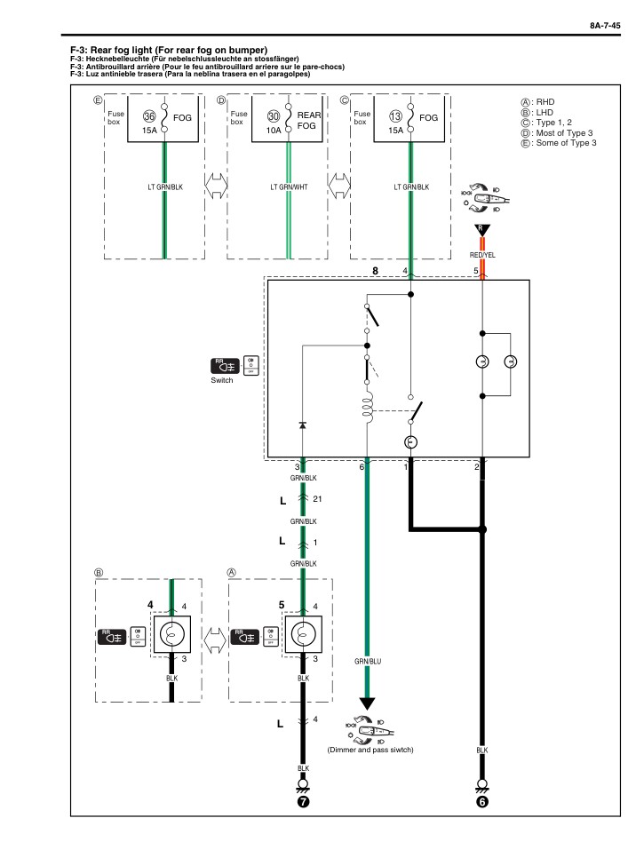

Thanks, yes that is the correct wiring diagram, I had also managed to dig it up elsewhere. My biggest problem was figuring out the pin numbering arrangement, but that is detailed in the official Suzuki manual. I needed that because the switch I bought was a second hand vitara one with different coloured wiring. But, all good now, I installed it with an LED bulb into the empty slot in the right hand bumper light unit. MOT tomorrow, fingers crossed.
16 Sep 2025 18:51 #261972
by facade
Replied by facade on topic Rear fog light for UK registration
Yeah, the first wiring diagram is obviously wrong, as now I figured out the switch from the second, as drawn the first will just ground the live feed when the relay operates and blow the fuse!
