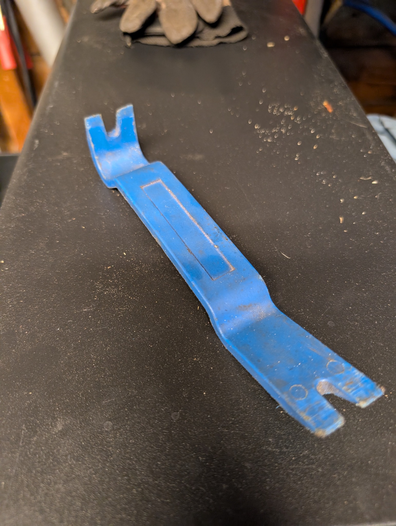

Slide a dining fork under the needle so that the tines of the fork sit under the boss on either side of the shaft, slip a paper napkin between the back of the fork & the dial to reduce the chance of marring the old dial, and gently ease the needle up and off the shaft.

Replied by yakuza on topic MPH speedo conversion?

In The Olden Days the works used to be held onto the face with 2 screws. then you used two spoons (nowadays every one has those trim tool levers) to pull opposite sides up at once against those screws, so the pivot shaft didn't bend.
Be careful that you are pulling it off square.
Again, in The Olden Days, when the speedo worked magnetically against a spring, the rest position of the needle was marked on the dial- you had to push the zero stop down and it came to rest well below zero.
Nowadays the speedo is a stepper motor, most likely you connect the dash without the needle, power it on so the motor sweeps and goes back to zero, then put the needle on at zero.
