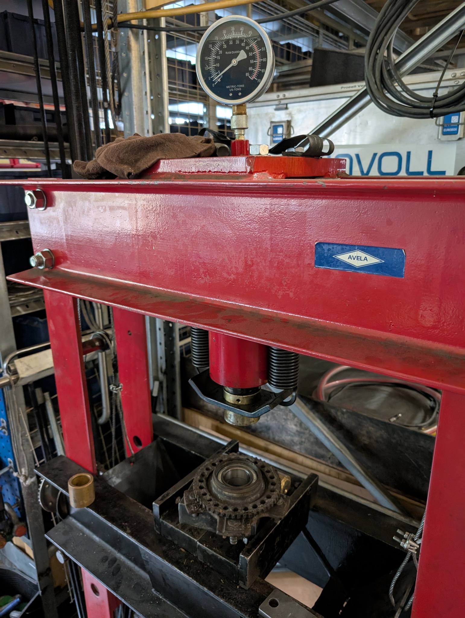

Went in pretty easy. Put the bearing in a freezer first. Was planning on heating the hub too, but Could not find a torch. Just 2-3 tons on the press so no big force.
And the rumble is gone.
Replied by yakuza on topic Front wheel bearing humm.

Correction : rumble is still there.
At speed doing right turns it rumbles. Doing left turns is silent.
I changed the right front wheel bearing, found the inner race had some play in it
Something Else? Other bearing?
