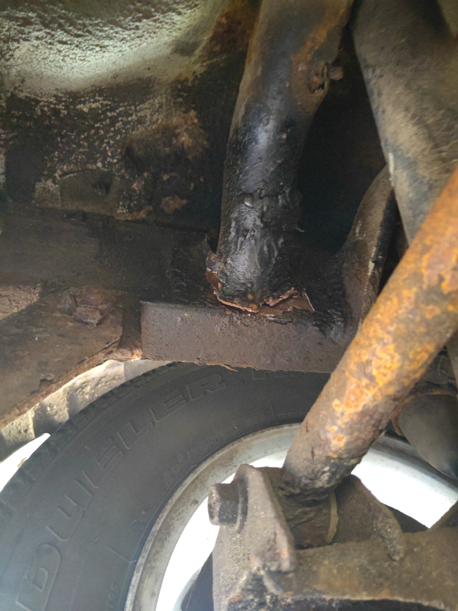

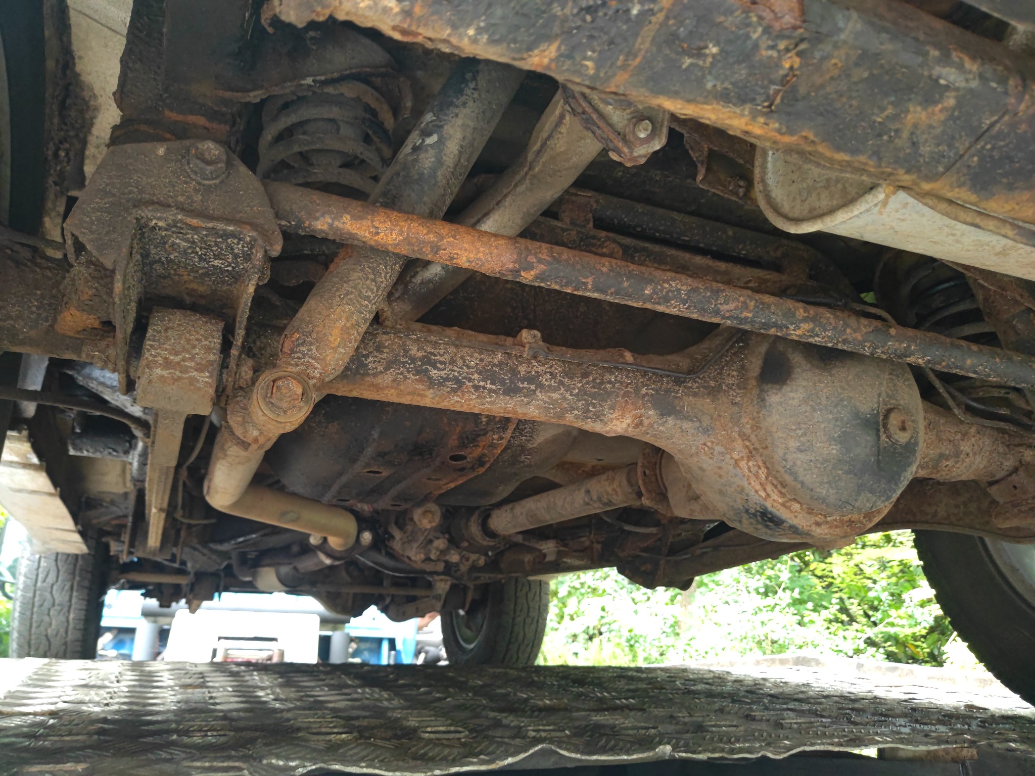

First picture is the general condition of the underside:
This is the main break:

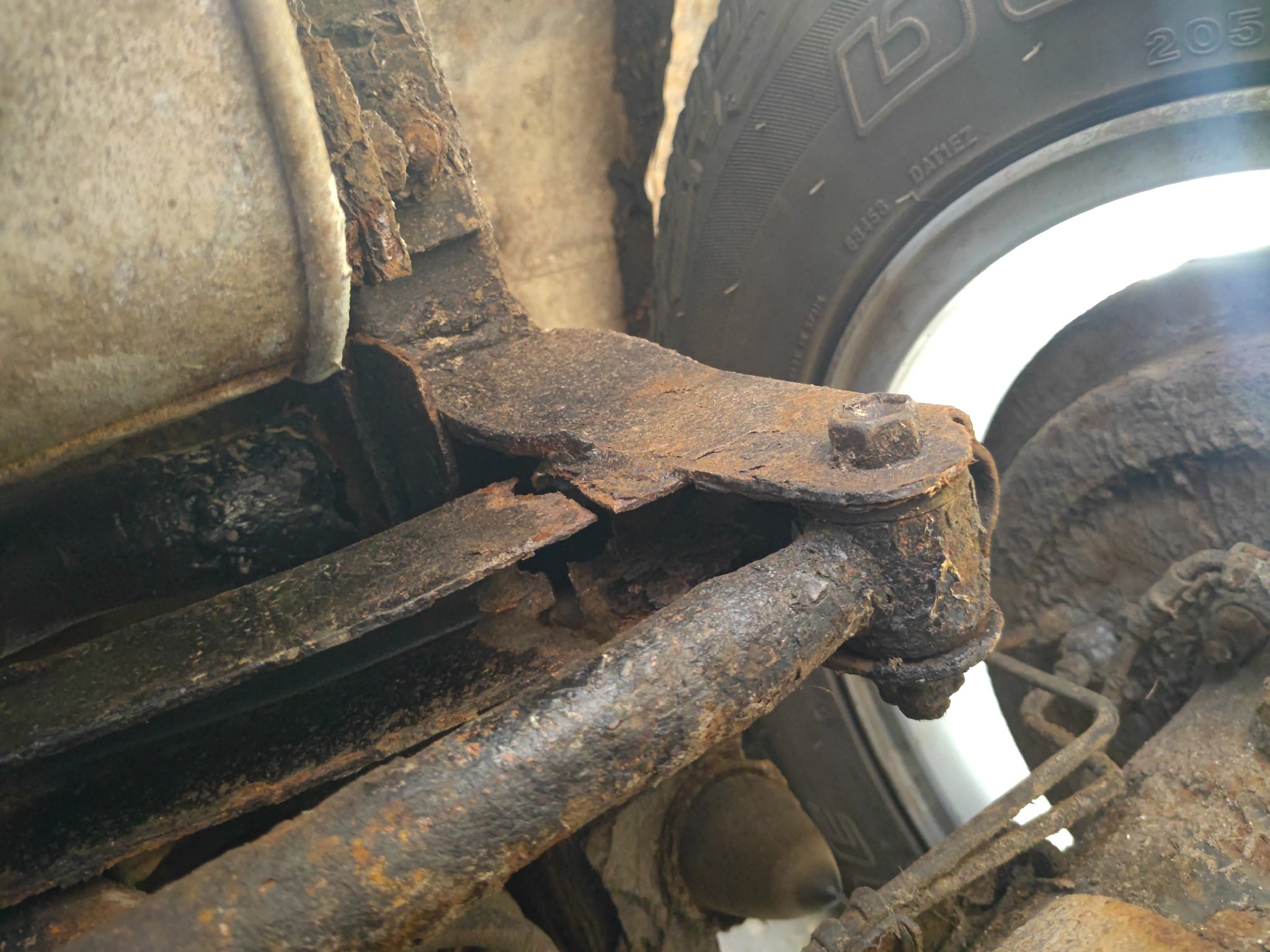

And here is where it has then gone on the other side, with the hole in the round bar at the top visible in the back:
So I recently bought a 2008 Jimny with just under 100k on the clock, which on the face of it looked good. The bodywork, inside the bonnet around headlights, jack compartment all look excellent with no real rust. I had looked at maybe 7 or 8 others before buying this one, and this was the best of the bunch for the money.
However, two months in and we suffered a serious structural fail (see pictures below)! The rear end is clearly now no longer attached to the chassis, as its just bobbing around on the springs. The thick round bar that goes between the two sides of the chassis by the rear wheel has snapped at one end, which has then caused the other end to snap on the square bracket and the join at the top is also well on it's way to snapping through the same as the other side.
