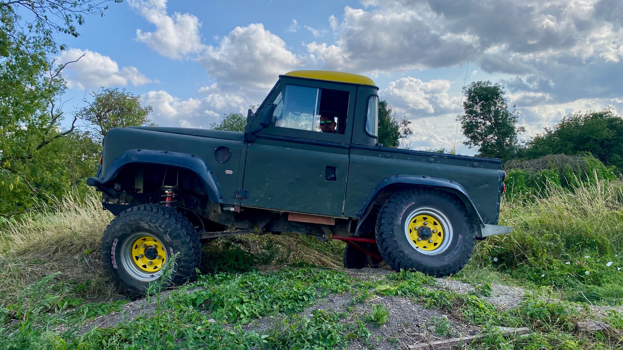

Back to tyres sizes.... this is my Land Rover. It actually has a shorter wheelbase than the Jimny (just). In this photo I'm running 33" tyres, so massively bigger than the 28.9" 235/75's on the Jimny.

Thats a serious looking Land Rover
