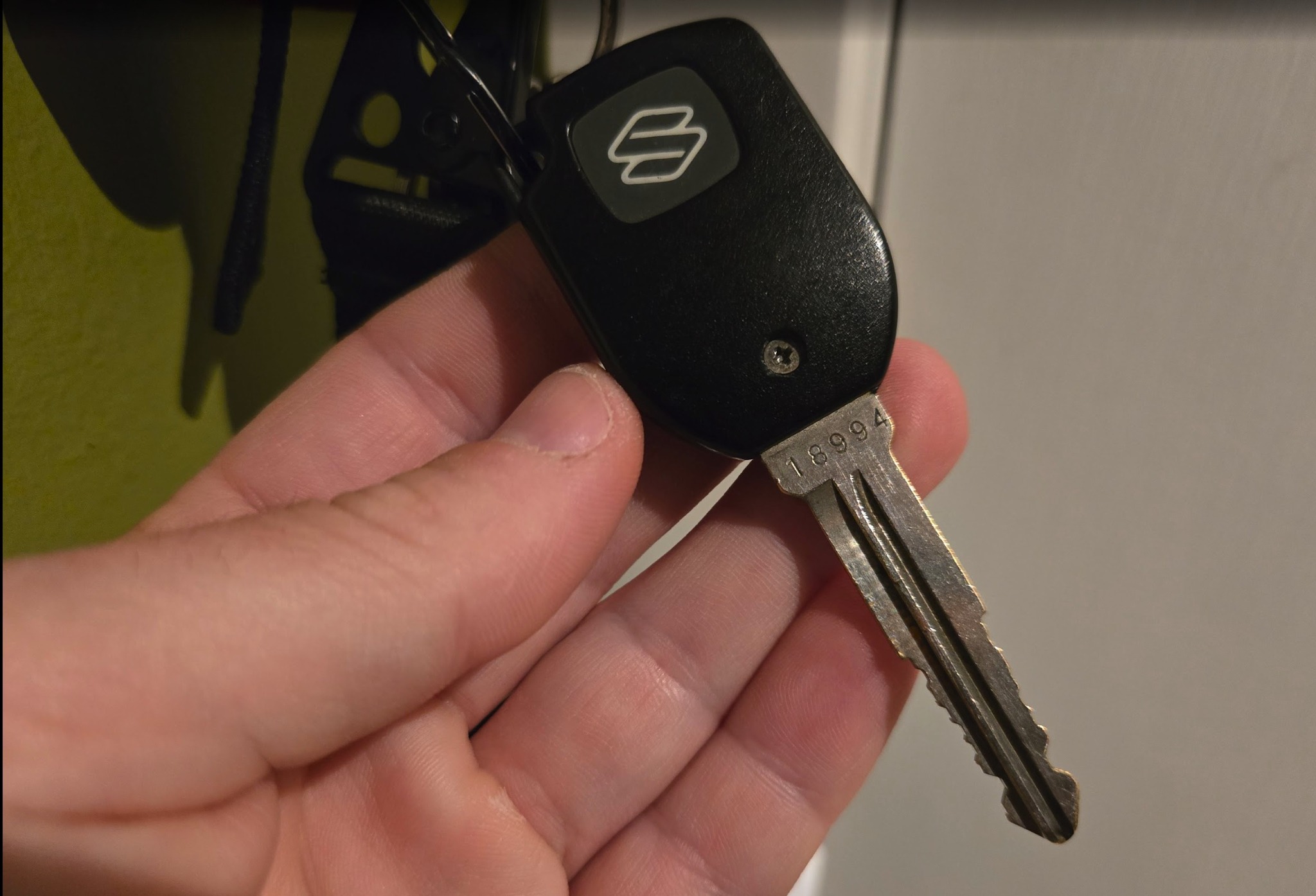

Whatever that is, it's aftermarket, and I've just realized we are discussing a JDM import, how about a picture of the key fob, let's see exactly what we're dealing with.

29 Jul 2025 18:25 #261372
by Crankshaft Culture
Replied by Crankshaft Culture on topic Gen 3 (JB33W) Key Fob Has Terrible Range
