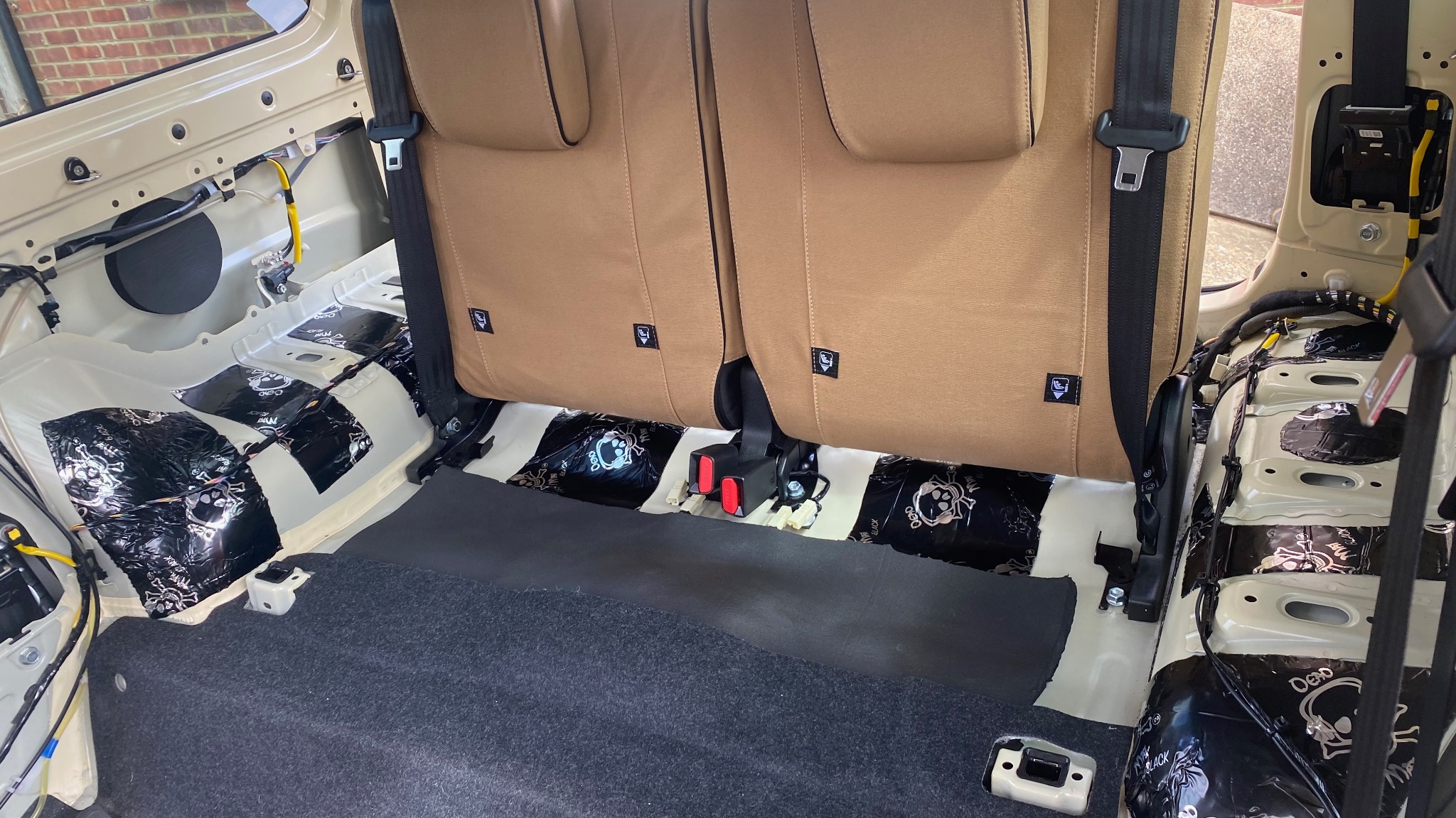

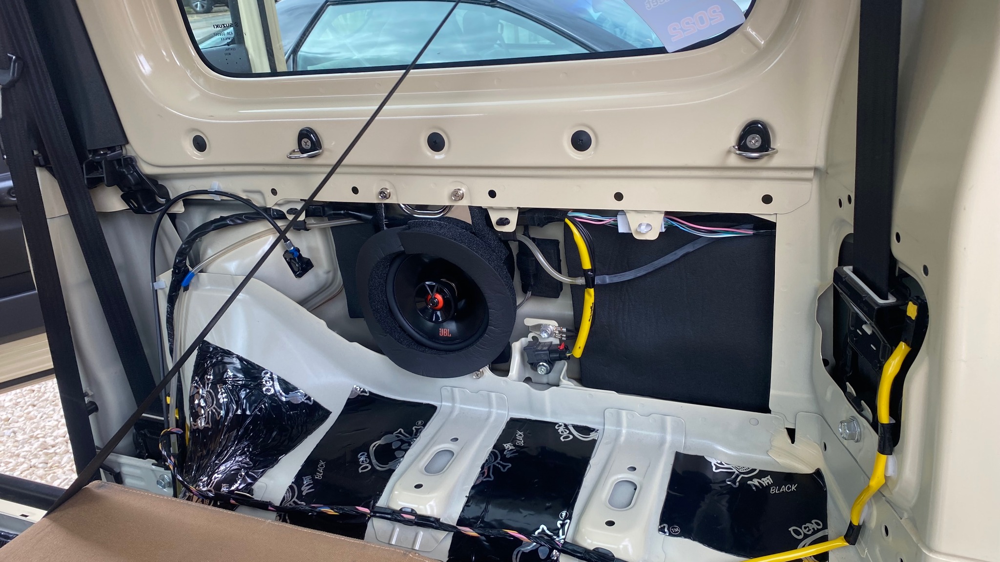

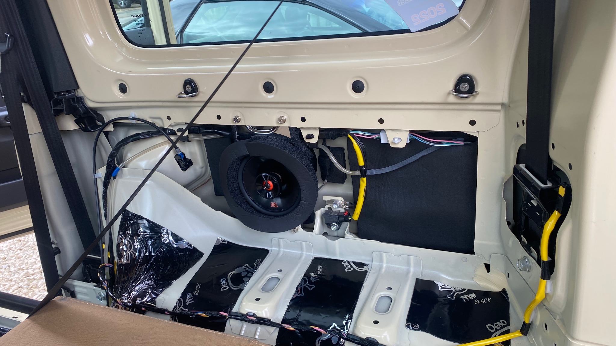

I did this to mine. Limited places where you can really put the sound proofing. The foam style stuff is very lightweight. There was a bit more in the boot under the tray, but again you can't just put it everywhere.
I was planning on putting some more proofing under the seats, front footwells and tunnel. But at the time I couldn't be bothered to remove the seats and other trim to make this possible.
The biggest difference I've noticed with what I've done is it has reduced the water splash noise when driving on a wet road. But I really don't think it adds up to very much weight gain on the vehicle.
