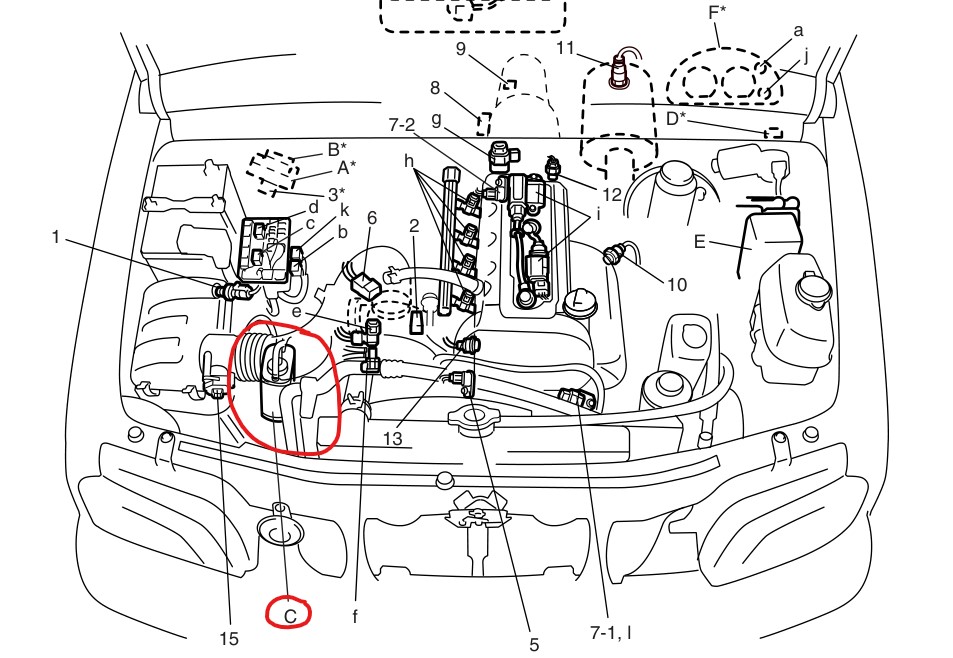

I'd remove the evap filter (the black plastic tank under the bonnet on the driver's side) and pour out any liquid fuel. leave the pipe from the tank disconnected until the engine is running and up to temperature.
