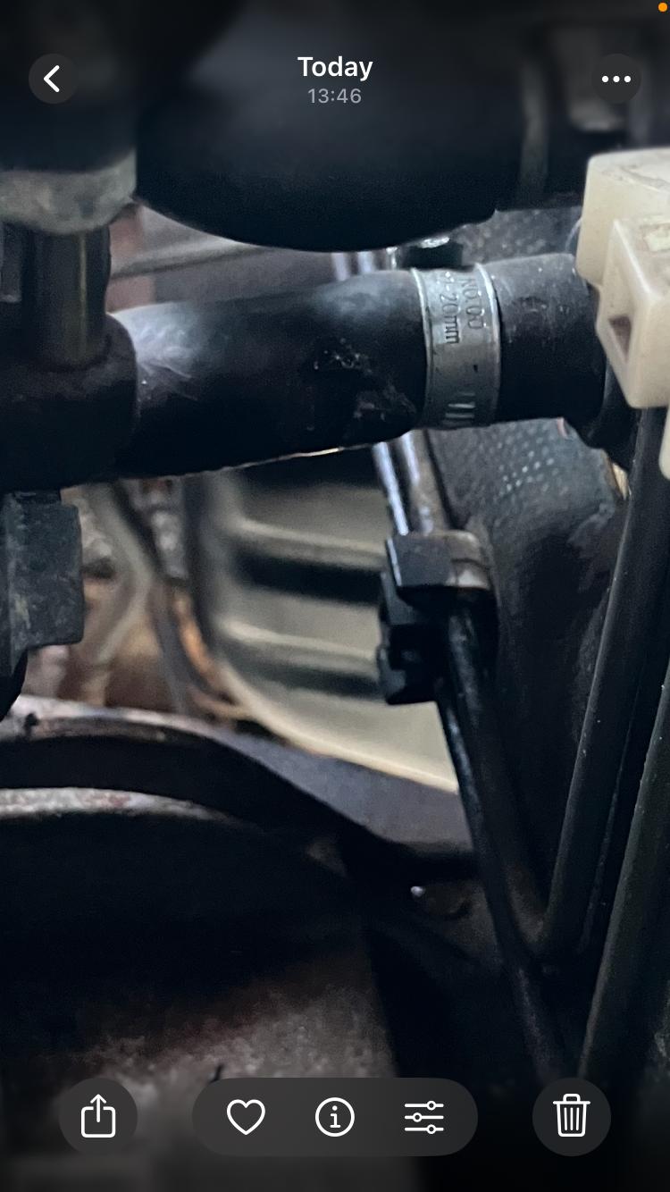

I've been out during work and there's no mega puddle underneath ,radiator is still full and the bottle was empty. I'm certain I've found the leak ! One of the hoses on the rear of the cylinder head has a slight crack in, I know these were a pain to fit during the engine swap, one of them has been disturbed before as the spring clip has been replaced by a jubilee clip.
Hopefully a new pipe will cure it and I've got away without any interior work.

Repair all completed and the hose had a pin hole in, when the pipe flexed it was squirting out under pressure.
