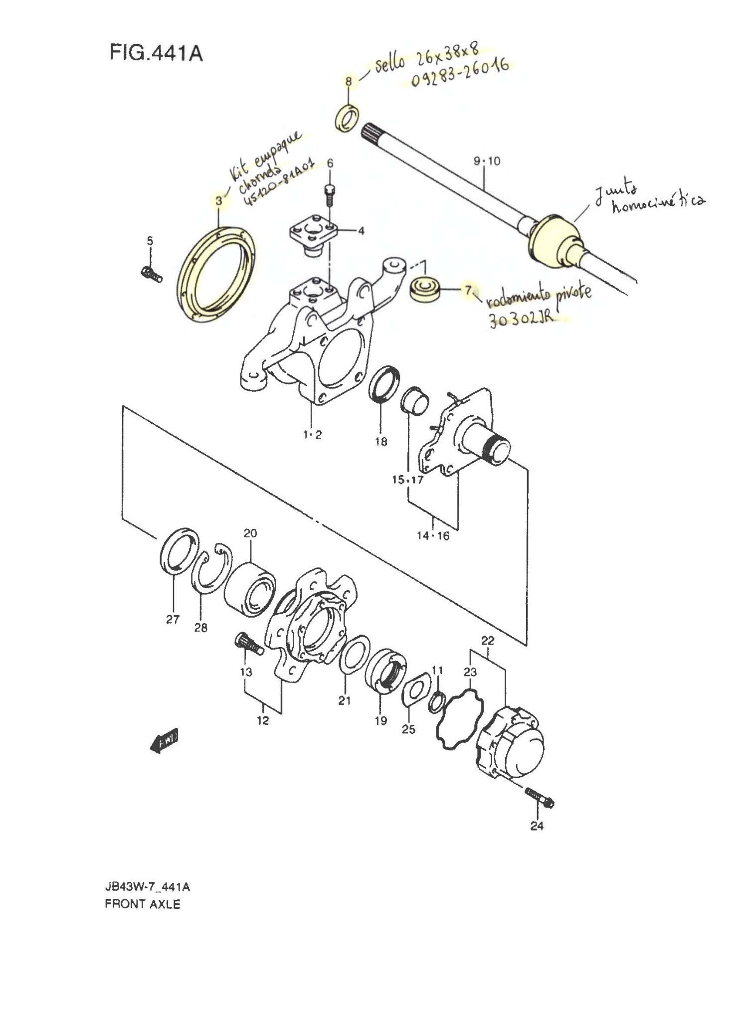

21 May 2025 15:57 #260527
by JimnyCol
Colombia: 2017 Jimny JB43, M13A 163,000 km, +4 cm XT suspension lift, TTS rear air diff locker, Easy Traction manual transfer shifter, AISIN free wheel manual hubs, WARN 55-S winch
Replied by JimnyCol on topic Visual diagnosis of a worn CV joint
Thank you, I guess I will have to buy these three parts, which are thankfully available at my local dealer
Price for one side:
Kingpin bearing 30302JR (Koyo) $39,000 = US$9.36
Oil seal 26x38x8 $12,000 = US$2.88
Steering knuckle seal 45120-81A01 $30,000 = US$7.20
Price for one side:
