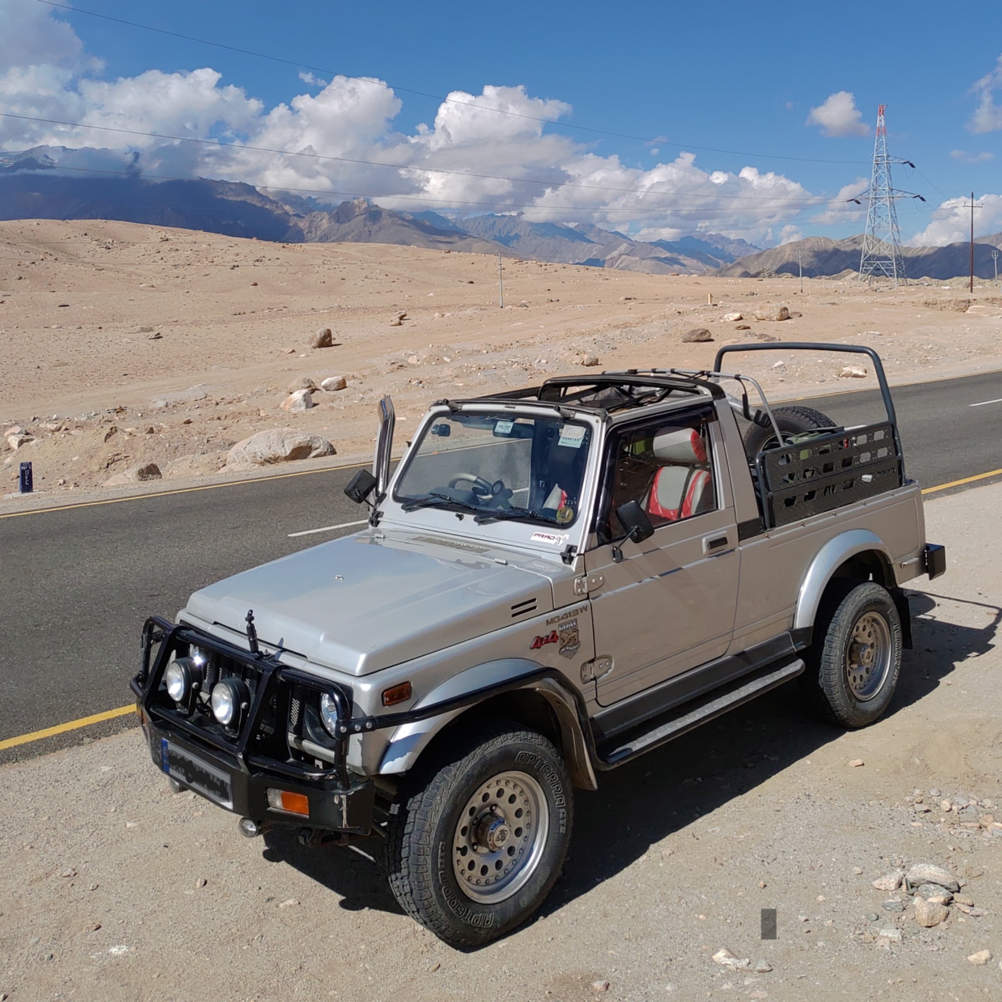

FYI The Gyspy is nothing other than the gen.2 Suzuki Samurai that was manufactured in India until 2019. Sharing a Pic of my car for some eye candy… (couldn’t resist 😅)
