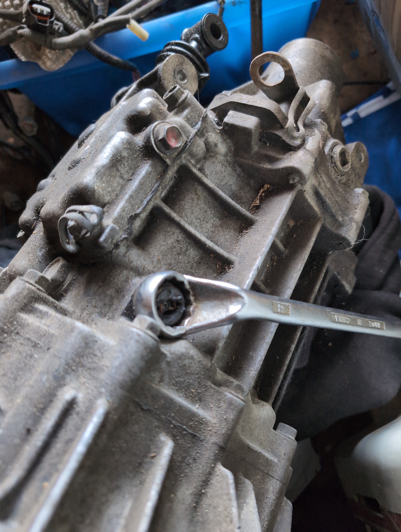

2007 Jimny how to remove back up light switch
22 May 2025 16:47 - 22 May 2025 16:49 #260548
Replied by yakuza on topic 2007 Jimny how to remove back up light switch
Had to go check as I have the car on stands and a spare box. If you had a slim ring spanner
it just might do. Very tight in between the housing ribs and a bolt. I would cut off the wires if I had to to get the ring spanner on.

A split ring spanner -- either bought or made from a standard ring spanner by careful use of an angle grinder -- is great for this kind of task.I would cut off the wires if I had to to get the ring spanner on.

My split ring spanners, also cheap, are even more bulky and the kit stops at 19.
I have grinded one down a bit for another task, but that only made it soft and more or less useless.
If I had to cut the two wires they are easily hooked back up with a solder shrink wrap connector.
Not sure if it was this or another connector that had a plug that could fit thru the ring spanner.

A proper quality ring spanner would be slimmer than mine and most likely fit just fine.

I'm not arguing with you. But some people aren't as good with a soldering iron as you are. I'm just giving another option.

Sorry, i did not think you where arguing, just wanted to make sure anyone cutting their wires hooks them back up properly to avoid further problems.
