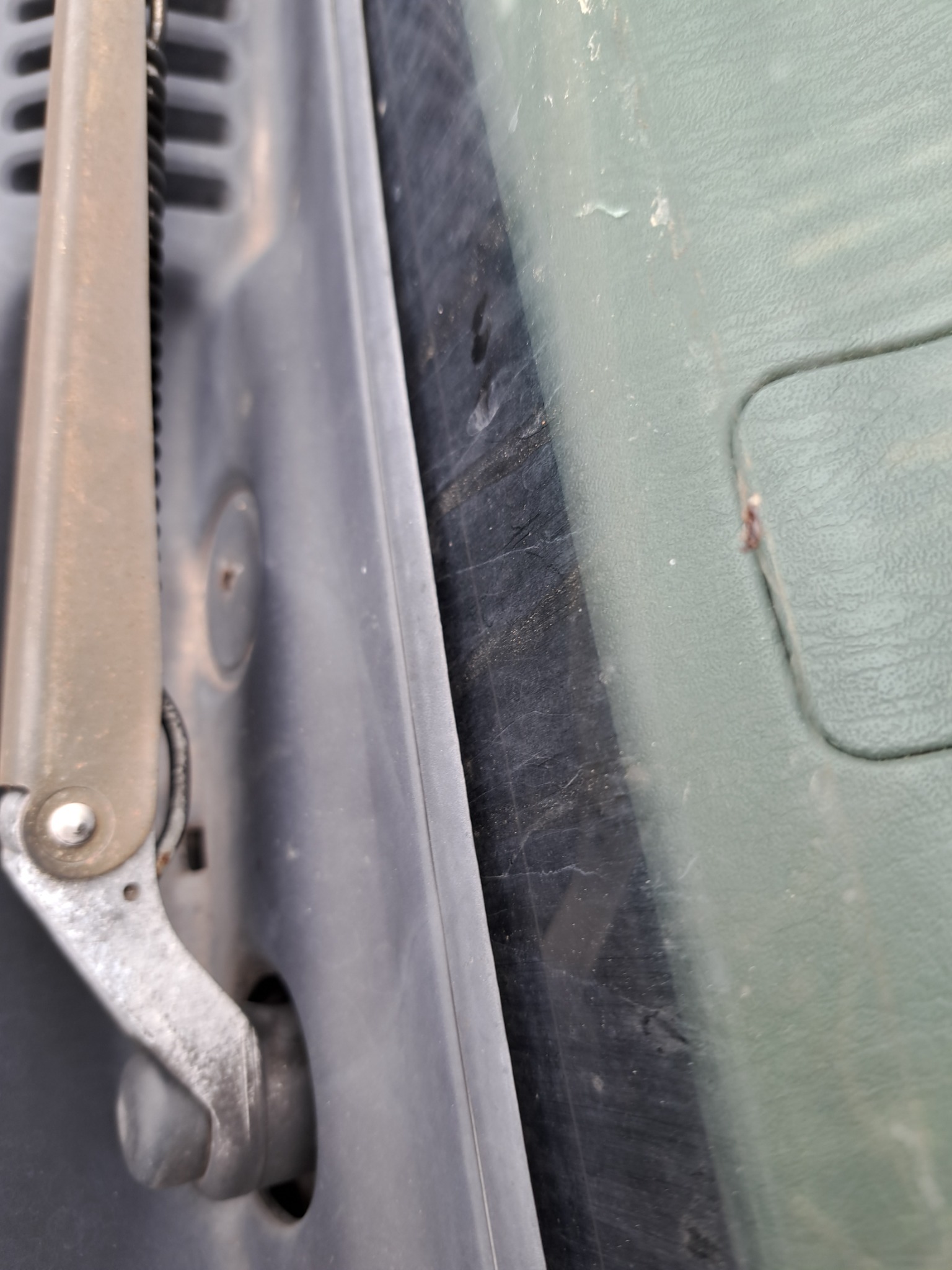

I tried cleaning the wiper drain holes and they're good.

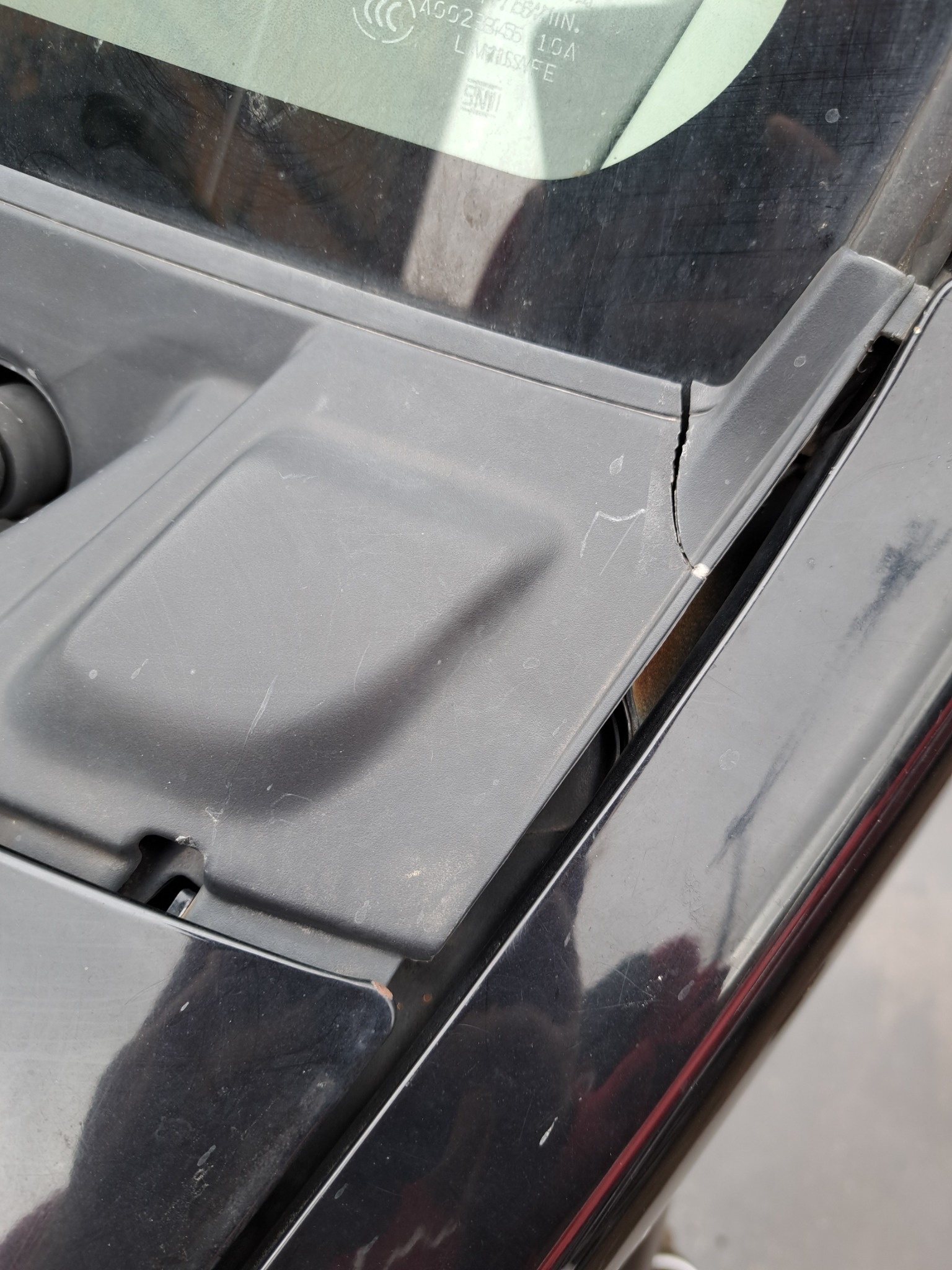

The windshield was replaced 1.5 years ago due to a large bird wanting to crash test it, and the guys that did the job left me with a cracked wiper cowl, only on the sides though, and it being bent in the middle, however when I poured water on the windshield and cowl, I found it to pour out of the underside of the fenders, as it should, I think.

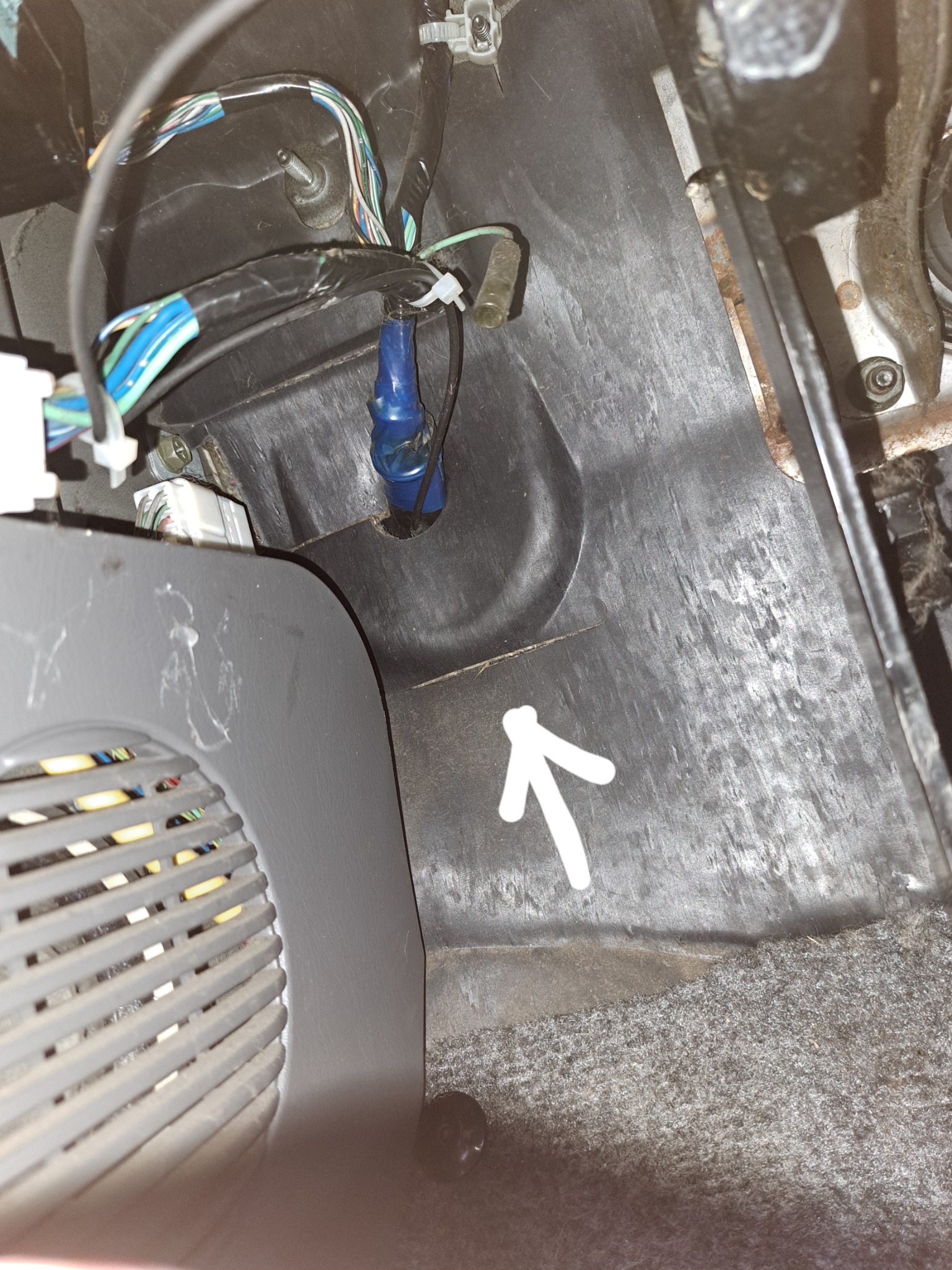

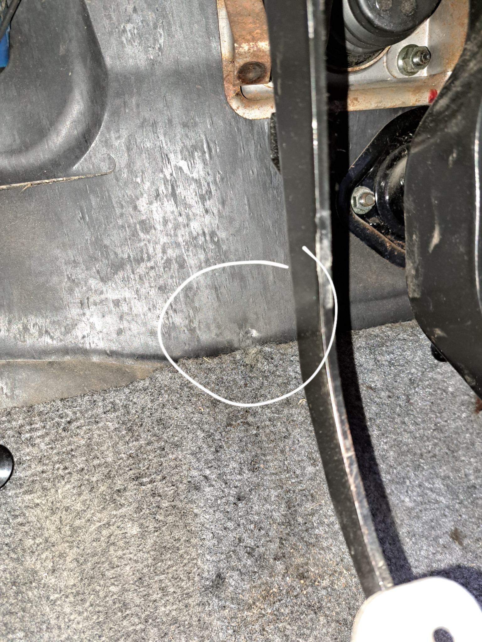

I checked today and having covered the front left of the cabin for the night I discovered a small amount of water on the floor mat, and the left side of the driver footwell and plastics wet.
Looking into the circular vent to the left of the clutch pedal I can see some wet cables, so I'm guessing the water is coming from either the left side of the glass or somewhere under the left A pillar.
If anybody has had any experience with this problem I'd appreciate a little info

What I'm thinking is they didn't glue it well in a spot, I can see a little bit of glue, like a string poking out into the cabin, and it's in line with where the trace of water comes from, I'll try to follow it up into the dash and see.

At this point I'll have my mechanic check the glass and maybe change the cowl, since it's broken
