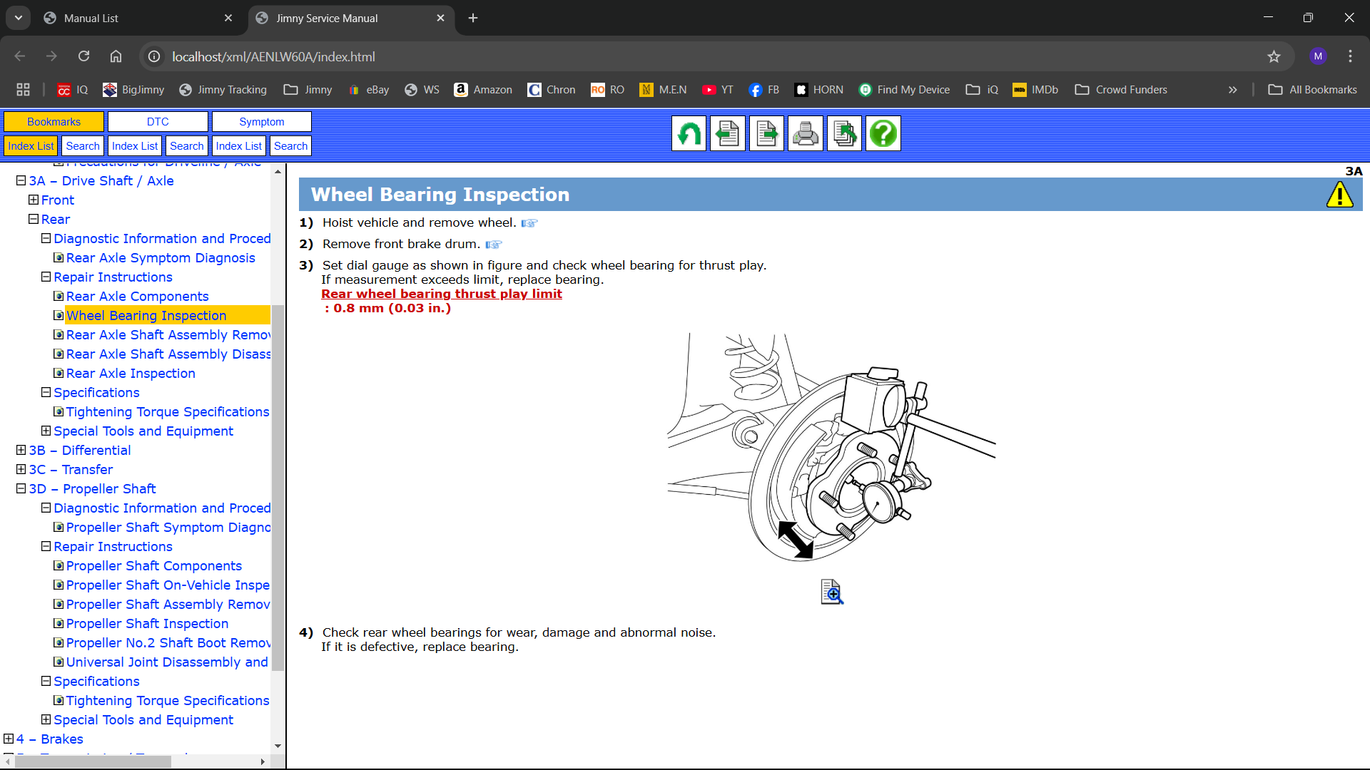

Recently I have started to notice a noise coming from the transmission somewhere. It seems more noticeable when just coasting to a stop in neutral, doesn't seem as obvious if still in gear. I jacked up the front and eliminated that end. The rear however sounds noisy, I can't say I have ever noticed this before so I am thinking it is a new development (but could be wrong?) I disconnected the rear prop-shaft from the diff to try and pinpoint the sound and wondered id it was a wheel bearing, but the noise can be heard from both sides, so could it be the diff? There is no play in the wheels and I have checked the thrust play in the bearings as per the WSM.

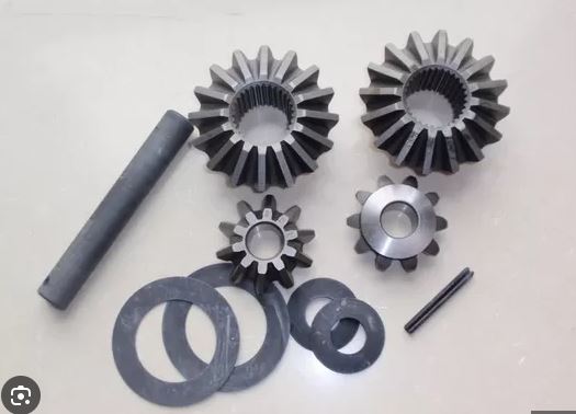

I don't know how familiar you are with the "innards" of the differential - the two side gears, and depending on the differential, two or four differential pinions, all bevel gears with chunky "straight cut" teeth, because they are straight cut there's a fair bit of "back lash" between the gears. It's actually a very crude affair, there are no bearings, the diff pinions run directly on the cross pins,
Under normal operation, the entire unit rotates as a single assembly, and because the gears are not rotating relative to one another they make no noise, when you're turning a corner is when the "differential action" occurs, and the gears rotate relative to one another. generally speaking, the difference in rotational speed between the right & left wheels is very small, so the rotational speed of the gears is also quite small and the noise is rarely heard.
