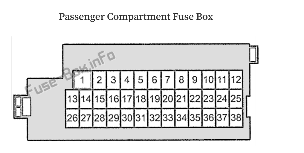

2020 Jimny (3 door, RHD, this fuse box: fuse-box.info/suzuki/suzuki-jimny-2018-2020-fuses ).
I had a dashcam connected to the fuse 19 holder (piggy back fuse). The dashcam had a problem and the fuse blew. I took the dashcam off, replaced the fuse on the piggyback but there's no voltage. I measured the fuse contacts in the fuse box; no voltage on either of the blade female connectors at the 19 fuse position.

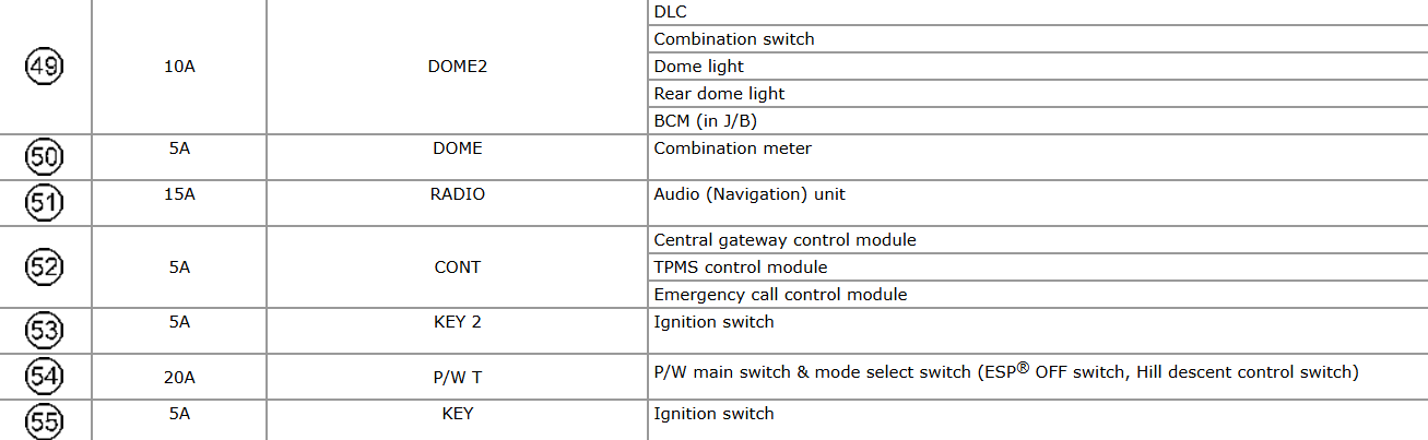

Suzuki label the fuses differently from that link you posted (where it shows two fuse 19s, one in engine bay, and one under the dash).
So for clarity this is from the link you posted showing #19
The workshop manual shows this a #52 'CONT'
Do you have TPMS or the Emergency Call feature fitted where you are? If so are they working correctly?

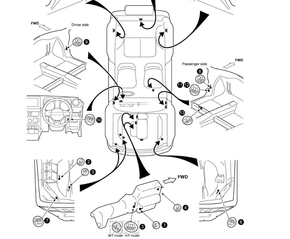

Both the Central Gateway Control and the TPMS are earthed at Earth point #10 which is under the steering wheel, is this still a good grounding?
