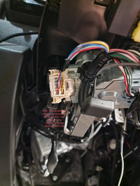

16 Nov 2024 15:11 - 16 Nov 2024 15:13 #258344
Replied by Soeley on topic Radio/Satnav not turning off!
Well, the ignition hasn't played up since, but I still had a look today.
There are three connectors on the ignition barrel, one at the 3 o'clock and 4 o'clock positions. And one right at the back of the barrel.
The connector at the 3 o'clock position is for the 'Key in ignition' warning. The one at 4 o'clock I don't know.
The one at the back of the barrel is the main switch, if you zoom in you should be able to see the label I've put on.
So for my issue I will be expecting the Dark Blue to stay live, if it plays up again.
