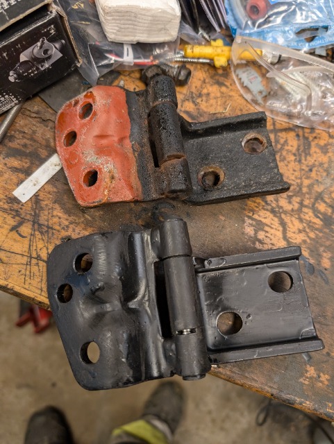

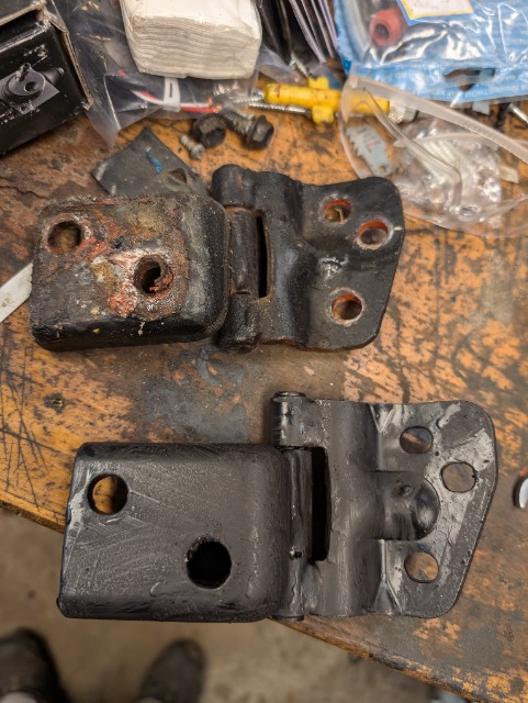

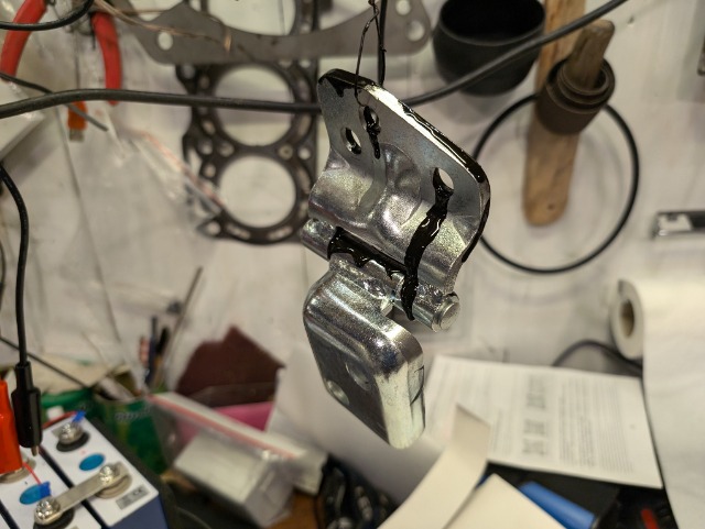

Back on topic now:
recieved the Febest hinge now. looks OK and galvanizing look strong too.
Still wanted some paint on it to make it last.
Febest on the bottom painted black.
My old hinge did not look so very warn but the bolt maybe a bit bent, maybe my car has had a collision on this part of the car.
Got the door adjusted ok and fits the hole in the car much better now.
The door opens and shuts easy and the door lock now slides onto the reciever at the C-post very nice and not catching like before.
the gap between the door and the car was like 0.5mm on top and 5mm on the bottom, and now is more comfortable 3-4mm even bottom and top
All in all this part looks OK for price. No idea for how long and may not have enough room for adjustment when it start to sag.
That might have to do with my car might having an injury and not being straight here in the rear, or my rear door saging from having a heavy 235 BFG on there for years now and a bag/sack of firewood too, making the door sag even more.
