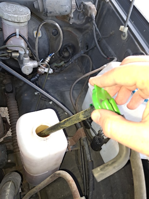

I also noticed a yellow substance in my coolant overflow tank, and under the radiator cap, of which I can't take a photo since the engine's warm. The car had been sitting for 2-3 years before I got it from my nan and the coolant was only changed earlier this year, but we couldn't flush the engine.

Unfortunately yellow deposits in the coolant nearly always means that oil has mixed with the coolant and this is often the cylinder head gasket has gone.
Are the yellow deposits oily?
How many miles/km has the engine done and has it ever over-heated?
You could try taking the spark plugs out to inspect (look for one which is washed clean) or get one of these dye leak kits to check.
