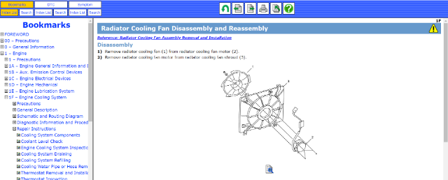

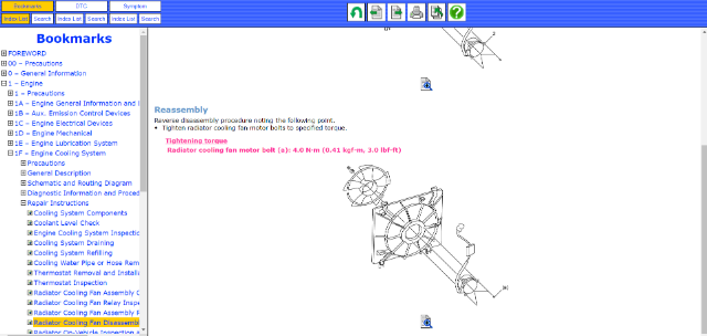

My woes continue ….. the “mechanic” is having some issues replacing the cooling fan. Some background:
Fan motor replaced by dealer at end of warranty
Fan blade hub failed - perhaps due to poor fitment of shaft key
Dealer out of stock
Been running a poorly centered Toyota fan in the interim
Vibrates like crazy so haven’t been using AC
So how’s the fan supposed to fit? Is ring A supposed to rest on collar B?
If you don’t tighten the nut securely the fan wants to wobble. If you torque it down the fan doesn’t spin freely. Am I missing a part? Dealer didn’t have a washer between the fan hub and nut. Tried adding one, doesn’t help.
Any inputs welcome …. it’s the end of summer but it’s still incredibly hot …. I’m melting!
