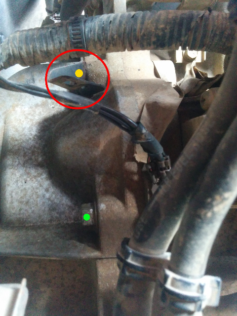

I found it quite easy to access the starter motor from above in a Jimny 2012 LHD.
- Remove the battery
- There's a black fuse box next to it with two wire looms entering it. Remove the 2 screws holding it (one of them is inside the box). Unplug the wire loom that enters the fuseboard from the top, but leave the wire loom that enters underneath. Push the fuse box out of the way and into the space where the battery was.
- Now the two bolts that hold the starter motor are accessible, M10x65, 14 mm hex-head (orig part no 01550-1065A I think).
The photo is taken from the space where the battery was. The head of the upper bolt is obscured by that wiring tube.
I should add that the wire tube is attached to a metal bracket, which in turn is held in place by that very upper starter motor bolt. Red circles the bracket itself, whilst the yellow dot indicates the location of the bolt's head behind it. Green dot is the lower bolt.

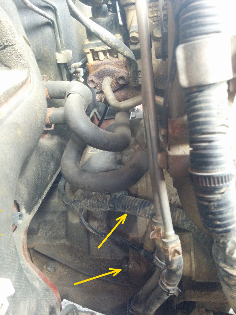

Hi. Thought I'd do a follow up on how it went for me.
Disconnect battery negative terminal
As I said earlier, I'd managed to borrow a ramp, which sort of made things much easier. And sort of not, in the way that whatever access you have from the bottom, even very good access from under a ramp, I don't think the whole job could be competed from under the vehicle, without some very special tools (very long extension bars.
Access is massively limited to the top (blind, as in it can't be seen) bolt. To make matters worse, the top bolt also retains a bracket.
So the order of play was:
Remove the wiring connections from underneath. You can't see these properly from above
Lower the ramp, and undo the 2 main bolts, from inside the engine bay. You can clearly see and access them, without moving or removing anything. A ring spanner easily cracked the bolts and a palm ratchet helps just getting them out (and back in).
Raise the ramp and after a bit of a tap to break the mating faces, the starter is easily removed from the vehicle, with a few twists and turns along the way.
New starter wriggled in, from underneath.
This is where it got a bit trickier and needs another pair of hands. The starter, tips under its own weight, so needs holding flush from underneath, while the bolts are reinserted and tightend from above.
Back underneath to reconnect the wiring and job done
Reconnect battery negative.
All done in 45 minutes, after we'd figured out it needed bolts needed doing inside the engine bay, then the removal and refit of the starter, from underneath
About 10 minutes of that, was needed from the extra pair of hands.
I reckon if you were to have this job done at a garage, they'd be ripping you off, if they charged more than an hour's labour
Cost me the price of a new starter (£90 with a 2 year guarantee), a bacon buttie and 4 tins of beer
