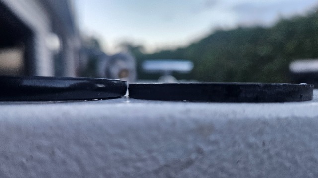

Basically, I googled up the closest parts store open on a saturday that stocked the thermostat I needed. The one in there (that I didn't think was opening quite right, as per previous post) turns out wasn't the right one anyway (PO had replaced) and the gasket / o-ring doohickey appeared to be in bad shape.

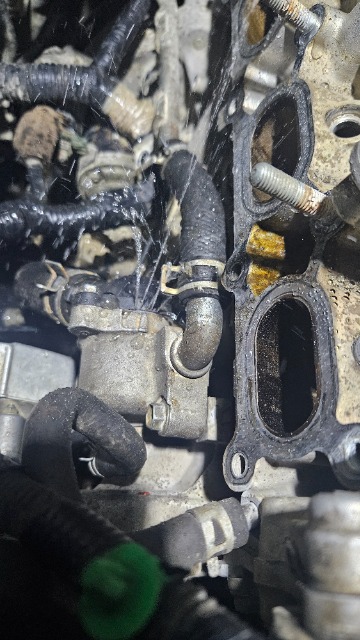

Anyway, where I left off last time I posted was reassembling everything with new parts and seeing what happened. I proceeded to do so and what I saw really slacked me off. Filled with water, cranked it up and watched as all the water disappeared onto the ground. Photo below shows what was happening once I pressure tested it with intake removed ( again ).
So out came the new t-stat and gasket, and I spent 2 - 3 hours trying every trick in the book to try and get it to seal. I even took the housing and cap to work and flattened the faces on the surface plate.
When I went to Suzuki to pick up my lower rad hose (they were the only place i could get one) I asked about thermostats and gaskets. They had them on the shelf so I grabbed one. Immediately on taking it out of the box when I got home, it was perfectly obvious what the issue was. The stupid aftermarket parts store gasket was never going to work. It was a different shape and way too thin to get any crimp in the groove in the housing.
To add insult to injury, a complete thermostat and gasket from Suzuki was cheaper than the parts store one. After me preaching to everyone about using genuine parts, ironically its me that gets bitten again.

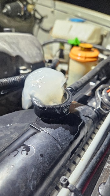

Yep, head gasket is toast. I used an extra strong radiator / cooling flush product to clean out the cooling system before filling with new coolant and heat cycled it quite a few times with the product in it and I think this is what finally made it give way properly. Foaming and bubbling when hot now out the rad neck.
Oh well. I guess its due for timing chain anyway so I'll do that while I'm in there. And the valave cover gasket leaks so that will be fixed as well. Clutch will be easier to upgrade with engine out too. (Had this for over a year now and not got round to changing it yet).
Anyone done this and found any special tricks / pitfalls specific to these engines? I've had a number of engines apart (not these ones though - Diesel V8's) and back together again so the process itself is nothing new to me. I also have the service manual.
