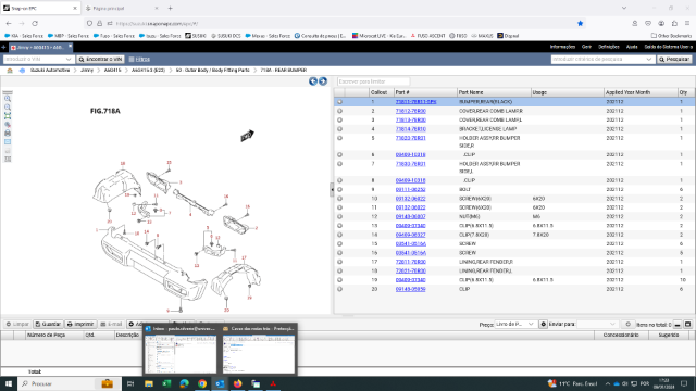

12 Jan 2024 23:07 #253468
by Filipao
Replied by Filipao on topic Inner covers on rear bumper
Thank you all.
Could it be part numbers 72811-78R00 + 72821-78R00?
13 Jan 2024 07:05 #253474
by facade
japanersatzteile.com/suz72811-78r00-000
www.xexpress.fr/ref-suzuki-72811-78R00.html
Odd that I can only find them on those German & French sites, you'd think they'd show up a lot more.
Maybe Martin can find out more.
Replied by facade on topic Inner covers on rear bumper
Could be, 72821 is Left rear 72811 is Right, they seem very expensive though, and I'd like to see what I'm getting first.Thank you all.
14 Jan 2024 00:14 - 14 Jan 2024 00:17 #253494
by Filipao
