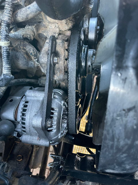

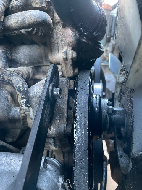

Hi,
Hopefully you guys can point me in the right direction.
TL;DR: Engine oil leaking on to belts, after overheating the engine, where to start? crankshaft seal?
The belts came off, I made it home after a mile, engine temp didn't seem too bad. But after replacing the belts and a new radiator hose, I started to notice a lot of oil leaking on the belts. From somewhere under the top radiator hose, but I can't be sure.
One post on here with a similar leak mentioned it the crankshaft seal gone. Could it be that, or anything else?
What else should I check after the belts broken?

did the belts tare apart or just fall off
cause could be de lamination of the crank pulley
oil leak i would say de grease front of engine
then run it and keep checking to find the source

The belts where completely shredded.
I'll clean it up again, and take a closer look at the crank pulley.

Have a look for a hole in the front cover where the edge of the pulley has hit it.
The belt is covered with oil. either the crank seal has let go big time and oil is running down the pulley, ( which is unusual, unless the shredded belts have got into the seal and damaged it) or the pulley has been vibrating into the front cover and cracked it or worn a hole.

I'll take the radiator out and have a look. I'll post back here what I find.
I vaguely remember pulling bits of old belt out from the crankshaft pulley.

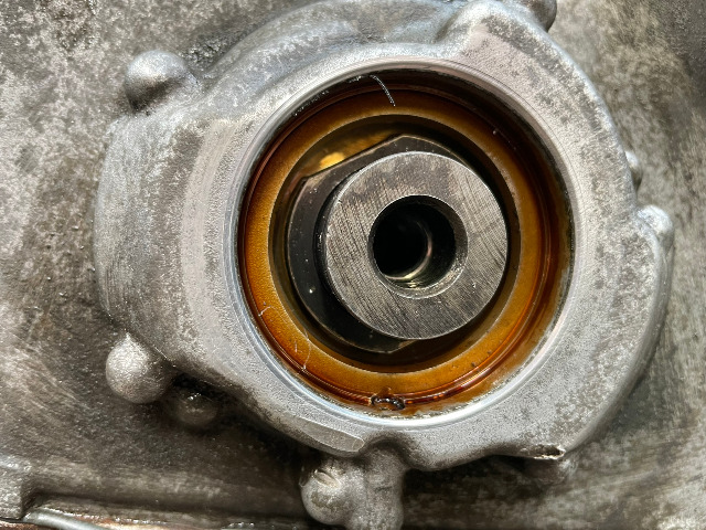

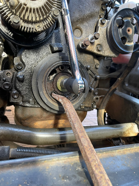

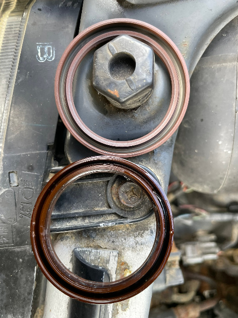

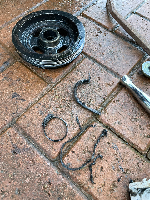

07 Mar 2024 14:47 #254886
by Pete
Rocky | 2004 Gen3 M13a
Replied by Pete on topic Engine Oil Leak after belts snaped
So seems it was the front crankshaft oil seal. Replaced it and no more leaking oil. There was a lot of the belt inside the middle of the crankshaft pulley. Gave that all a clean.
Someone's advice on here (DrRobbin/Lambert maybe) recommended using the old seal and a block of wood to get the new one in was spot on. Thanks whoever said that at some point in another thread.
All of these bits of belt came out of the pulley
