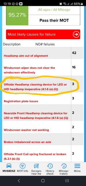

14 Dec 2023 13:26 #252873
Replied by Soeley on topic Blocked Headlight Washer Jet - Again!
I just got the 4 week reminder for the MOT from the Know Your Car app.
It gives rgives it might fail, I presume from actual failures.
It looks like 3 have fail on the offside headlight washer.
