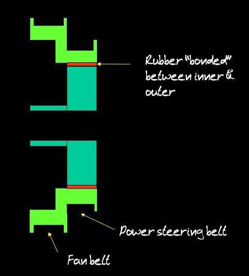

22 Nov 2023 23:08 - 22 Nov 2023 23:09 #252314
by facade
Replied by facade on topic Squealing belts? but only when lights, heating and windscreen wipers are all go
Check the bottom pulley.
The "design" is very poor, and tensioning the alternator belt tends to rip the outer grooved part (light green) off the inner hub (mouldy green colour)- the inner hub is bonded to the outer grooved part with a thin strip of rubber between the parts (red).
The result at first is that the belt is difficult to tension, eventually when enough of the rubber delaminates, the outer pulley vibrates frighteningly as the engine is revved up, until it eventually falls off along with the belts. Then it is time for the recovery truck as you can't get any drive to the water pump and the engine will overheat.
Try and pull the pulley off, if there is any movement you need a new one.
