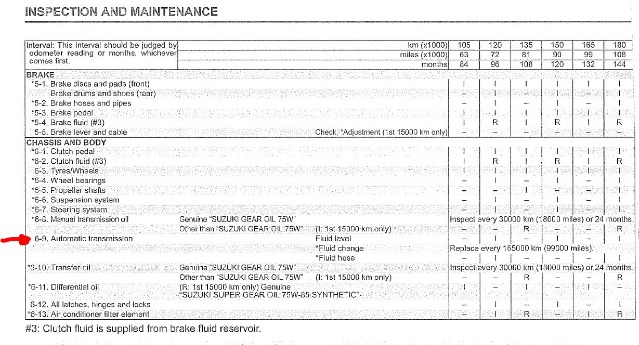

Check your owner's manual, the fluid is replaced every 99,000 miles or 18,000 under severe driving conditions.
The Jimny has an old style torque converter/planetary gear automatic transmission, the bulk of the fluid is trapped in the torque converter and the only way to get it out of there is to disassemble the transmission, your options for a fluid change are limited to multiple drain & refills if you're doing it yourself or take it to a specialist with a fluid exchange machine.

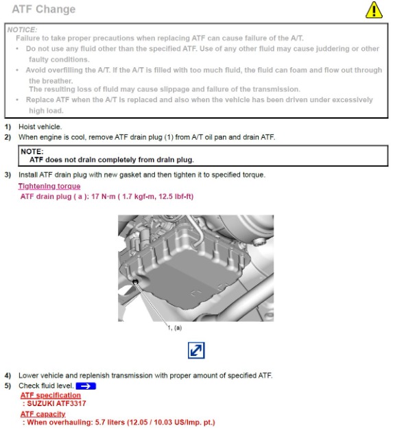

The Jimny (JB74) service manual procedure for changing ATF is basically about draining from the bottom plug and replenishing the same amount drained (this is very important as overfilling also causes a variety of issues), so I am guessing there is no need to go for a complete flush and probably the ATF change interval was devised with a partial change in mind.
