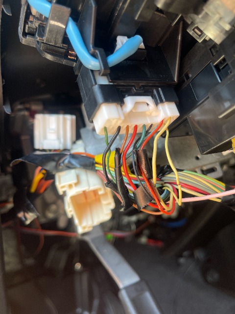

Well It's been a while
Here are my findings.
Your European Jimny seems to be way different than the ones we have in Latin America. I've been studying what you said about the CANbus and the BCM toggling the lights and for ours, this is not truly certain maybe for your Jimnys in the UK they do but ours are different.
Let me explain, the lightning lever has four states 1. off - 2. parking lights on 3. low beams and the last one as you know is when you push it on the low beam position it toggles the high beam
In the photo I attached I managed to find that the brown wire is the one that switches the parking lights so if you add power current externally to that wire it will turn on the parking lights.
My problem is that I need to know now which wires are the ones that carry the other states of the lever (low beam and high beam) I do know this is a negative switched system as I mentioned above (most Japanese cars are like this so that's how I already knew it)
Now here starts the new stuff
If you can see in the photo there are two red wires, these two red wires are somewhat related to the low and high beams. They change polarities and drop voltages when the lever is in the low beam position.
I grounded one of those red wires and it switched the high beams so now I know, that in order to toggle the beams on the car I just need to add a ground signal to one of the wires involved
Now My issue. Is pretty hard to tell which wire is the one that carries the Low beam toggle signal which is the one I need to toggle in order to finish my project
