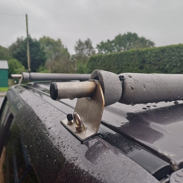

I made some custom stainless cross bars that replace the factory plastic ones. While I am conscious of the weight limit I am also much less concerned now that the bars are directly bolted to the roof. I previously had a pair of bars for a BMW 1 series amongst other fitments as the feet near enough matched the studs in the roof. The other thing is that with just cross bars I am maximising the available load capacity by having the minimum structure.

Replied by Lambert on topic Thule foot pack fit
