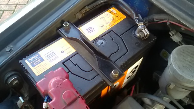

I've just fitted a HB057. Universal terminals (remove std terminal to expose JIS).
2009 Manual, works and fits fine

The next step down the Yuasa tree is the YBX3057, 45AH and 400CCA.
That's the same battery that Halfords sell as HB057, Yuasa make Halfords batteries, or at least they did when I worked for them. Very cheap with a Halfords trade card and just down the road with a no quibble warranty.
I believe the one I removed was a Bosch 155 (B33), nothing wrong with that, it was just old and needed changing. Same footprint as all the others mentioned. The 054 has the terminals the other way, +ve near bulkhead in my photo.
So the correct battery is the one that physically fits, any of the above, balanced against how much you want to spend. Generally more Ah is a good thing if you can get it.
