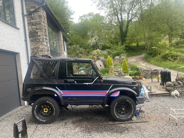

Ok it’s a Sami… but the shape is the same. They are 215/70’s with an OME 40mm lift. I reckon it’s up about 2” on the front and 2.5” on the back.
When the BFG’s are done I may go to maybe a 29 but I don’t want the wheel weight and lack of manners. I do want the breakover angle which is invariably where I get the current Jim stuck.
With the little lift and tyres and different chassis arrangement it looks like I’ll have gained about 90mm from the stock Jim so that should make a noticeable difference.
