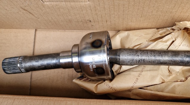

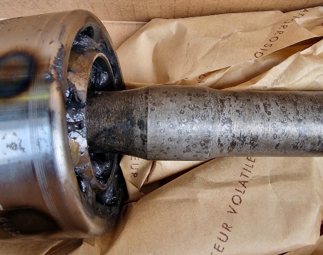

Hi all,
I've bought a new GKN / Löbro driveshaft to replace the long one in the front as mine was badly grooved from the oil seal.
The new one has a very rough surface on the area for the oil seal. You can see the grooves from the lathe that turned this. I reached out to the supplier and wondered if this was a manufacturing error. I was expecting a ground / polished surface. The reply was that this was ok and I could go ahead and install it. I'm very skeptical to this, and fear that the life of that seal will be short. I also quickly measured the diameter of this area, and the old is about 26mm, this one is about 26.2mm, which makes me think this was left for a grinding / polishing that didn't happen. What do you think?

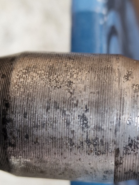

Replied by yakuza on topic New driveshaft - manufacturing error?
No Way!
That surface is also prone to make the shaft weaker as the roughness makes cracks appear easier.
No way that any seal would last long on this.
Return it. Any used shaft would be better.
Edit: And yes, It looks like the final grinding after hardening have been "forgotten" as the surface looks like the heat treatment from hardening or annealing. Normal to leave 0.2mm (or more) for final grinding so measurements also indicates that someone had a bad day.
(I am an engineer btw, working with manufacturing large machinery. Have not had any problems with buying industrial stuff from GKN before as far as I know though.)

I agree. That surface will chew a seal to bits.

Well, now I'm a bit surprised.
I initially only sent the first couple of pictures to Autodoc and asked for a comment, which really should be good enough with a margin. Now I went back and sent the really close-up one and requested they had another look. I had sort of expected a reply along the lines of "yeah, that is not how it should be, send it back and we'll arrange for a new", but no. Once more they were quickly back to confirm that this one is as it should be, and that I should go ahead and use it. Kind of peculiar that the CV joint has a nice ground / polished finish, as it should be, but they (Autodoc) see no connection to the other sealing area.
General recommendations for sealing surfaces like this is surface roughness of RA 0.2-0.8 micrometer. We are not exactly there, and clearly Autodoc doesn't appear to care much after a sale, so I'll go and look for another source for a new shaft. Life is to short to get the blood pressure up. Anybody know of one?
