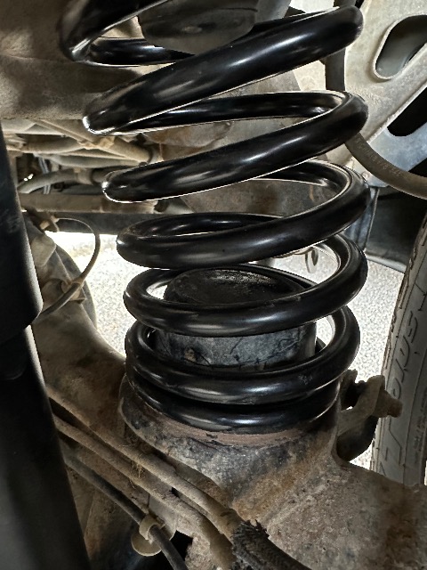

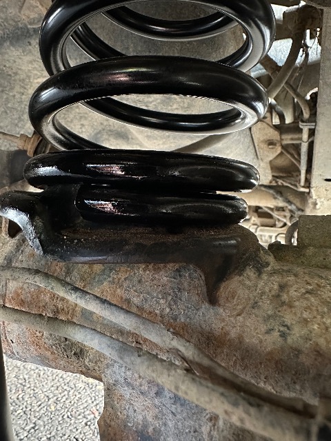

I fitted a Black raptor 2" lift kit today and I forgot to check which orientation the old springs were before I took them out. I've second guessed it but unsure if I am correct. Can someone tell me which way round they go please?
Front
Rear

As in which way up? The flatter end goes to the top, the more open coil fits into the seat on the axle. As in left or right? If there's a longer one it goes in the driver side.
