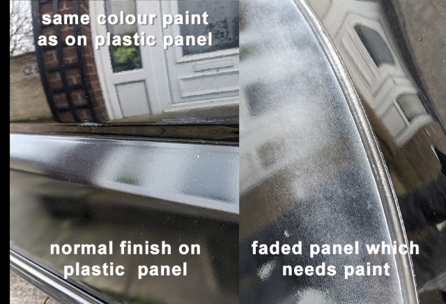

I painted the plastic panel on the passenger door using a pot of spray paint and spray pencil (large nozzle). It took a couple of coats and then some cutting back to get it even. I also applied a laquer afterwards.
I just bought the paint using the paint code, if anything it is slightly lighter than existing paint which was a surprise given colours usually fade. Still if you spray the whole panel no one notices, especially as the finish looks different on plastic and metal.
I didn't bother with a primer, as it was still painted, just roughened the surface.
I took the panel off to do it in the shed, mostly as I have to spray on the car outside and the weather wasn't very good.
I have also had good results with aerosol cans, but the texture of the finish nearly always looks different. Go to someone who mixes then cans the paint if you go this route. Getting the right amount of paint down is harder with a can so expect to have a practice first, again taking the panel off and doing it inside helps.
I used aerosol primer, paint and laquer to re-fresh some alloy wheels recently, I was very pleased with the result, but the wheel paint is a semi matt finish which is always easier to spray.
